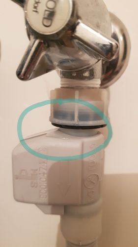

Hi, I've just moved into a new place and trying to connect my washing machine up to the tap but it keeps leaking from the connection circled in the picture. I've tightened it as much as I can and the washer inside the hose seems fine. Please help! Thanks

If the water leaks at the red arrow, you might like to add more sealant tape to the tap threads. If the water leaks at the orange arrow where you've circled, it indicates the internal washer might not be sealing correctly. You could try replacing that washer. If you take the internal washer to your nearest Bunnings store, so helpful plumbing team member can help you match it up to the correct one. If the internal washer is fine, the plastic fitting might have developed a slight hairline crack and the hose would need to be replaced.
