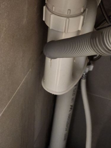

How do i fix the water leaking from washing machine hose to pipe?
Welcome to the Bunnings Workshop community @carita. It's sensational to have you join us, and many thanks for your question about fixing a leaking washing machine pipe.
Do you have a hose clamp holding the corrugated waste pipe onto the waste spigot? If not, I would advise installing one as it might stop the leak.
In the image below, I've highlighted a potential split in the waste. This might just be an anomaly in the image, but if it is a split in the waste, a plumber will need to replace it.
