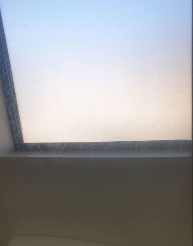

You name it I've tried it - vinegar, bicarb soda, bleach, BAM, CLR. Nothing is getting rid of the white calcium build up on shower glass.

Hi Mitchell, here is the best photo I can take. What you said could be the reason and nothing seems to be working.

I assume that's in the mid-screen @joejoe? This penetration of the laminated panels is generally found close to the floor, but it wouldn't surprise me if there were some build-up further into the middle of the pane.
If you look at the clouding from either side of the glass panel, does it look like it's in the same position? If it is indeed on the surface, by looking at it from outside of the shower, you should be able to tell that there is the glass's thickness, and then it's on the other side. If it looks the same from both sides, it could indicate that it's right in the middle, between the two panes.

Hi Mitchell, yes this is mid/ upper of the shower screen. If it was calcium build up on the outside would it not feel slightly rough? As the glass has no texture, and yes thr clouding is the same from inside/outside

I believe a calcium build-up would feel somewhat rough @joejoe. To me, the discolouration most closely resembles that of soap scum, but if it were on the surface, you would be able to remove it quite easily. Alternatively, it could be a fine white mould growing between the panels.

I have tried the blades scraper but this does not seem to work. You can feel the blade scraping across the buildup but it doesn't seem to remove it..
