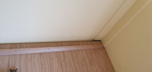

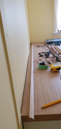

Hi Team. I'm renovating my 1940s farm home. The walls in the laundry are not square so I'm installing quad moulding to cover a small gap between the back of my new kaboodle benchtop and the asbestos wall. What should I use to attach the moulding? Is a brad nailer suitable to go into the asbestos wall? I will use a router to shape the moulding around the cover strips.

For this reason, you should not use brad nails. Anything that will pierce the asbestos and potentially cause fracturing and the release of fibres is not advisable.
I would suggest using Selleys 320g Liquid Nails Original Construction Adhesive instead.

Generally speaking, brad nailers are used for the installation of trim such as this, but I wouldn't be comfortable shooting them into an asbestos wall.
You could certainly use brad nails that are shot into the benchtop to secure the trim in place.
This would give you a nice solid connection without piercing the asbestos wall.

I understand your desire to securely anchor the timber moulding to your asbestos wall, but it is inherently dangerous. Strong hitting motions against it are enough to make your walls vibrate thereby releasing asbestos particles into the air. These may seem minimal to you, but even a small amount is enough to cause contamination in the area. The last thing you want to happen is to have the asbestos particles to spread inside your household.
In the interest of health and safety, I don't recommend any hitting motion to be applied to your asbestos wall. I propose looking at using Selleys 290ml Hold Up Construction Adhesive. You can then use heavy weights to hold the timber moulding in place.
