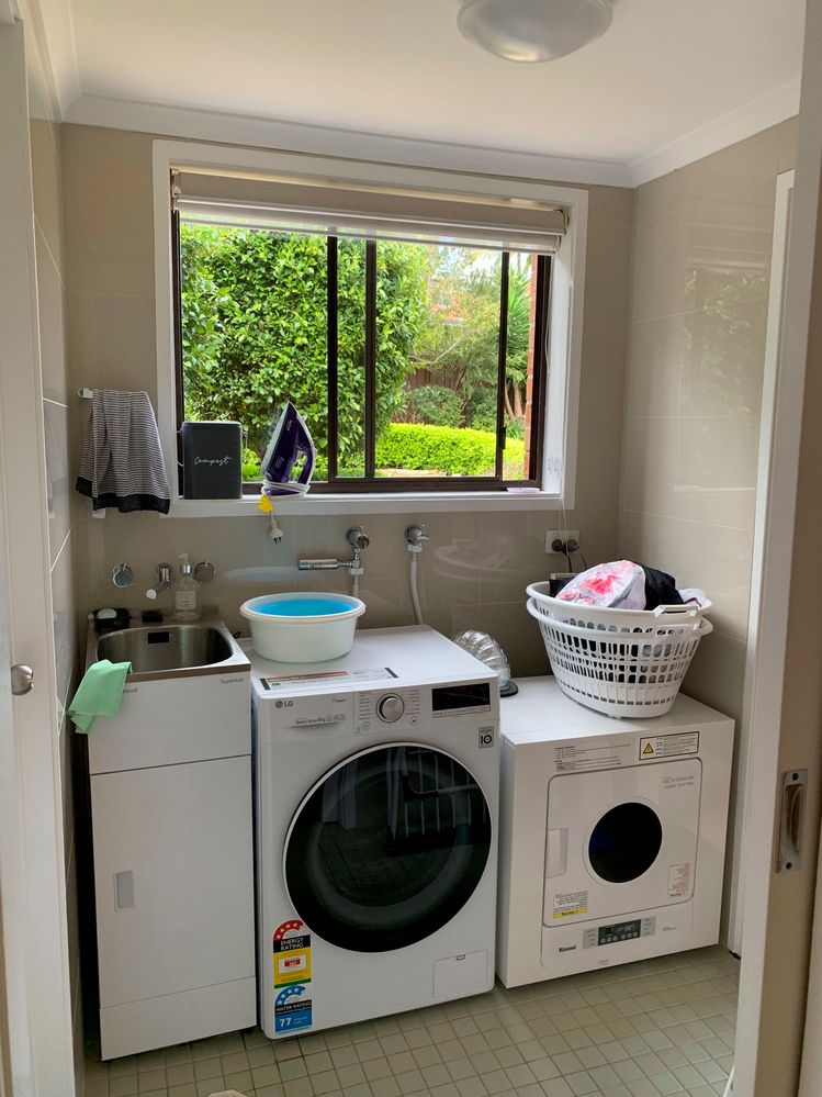

I'm trying to attach slotted metal angel to tile, the wall behind is stud wall. What would be the best way to attach them?

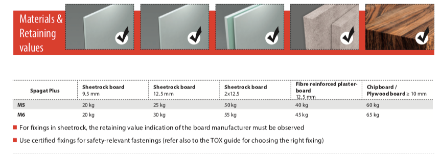

From Tox M6 Flip Toggle Bolt rating chart, M5/M6 provides 20kg per bolt, I can get the number of bolts I need after weighting the benchtop.

It's a full tile wall unfortunately but I think using couple of Tox Spagat Plus M6 would provide far more enough weight than I need.
@TedBear thanks for mentioning that. I use a 2200x600 bench top about 24kg, I need 1700mm so comes down to 18.5kg. With weight of items adding on top, 5kg is a reasonable amount for laundry stuff, I think the overall weight is safe to rely on these dry wall anchors.

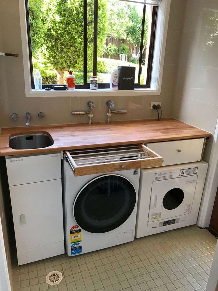

thanks for the advice, I'd like to share the progress of my laundry makeover project.

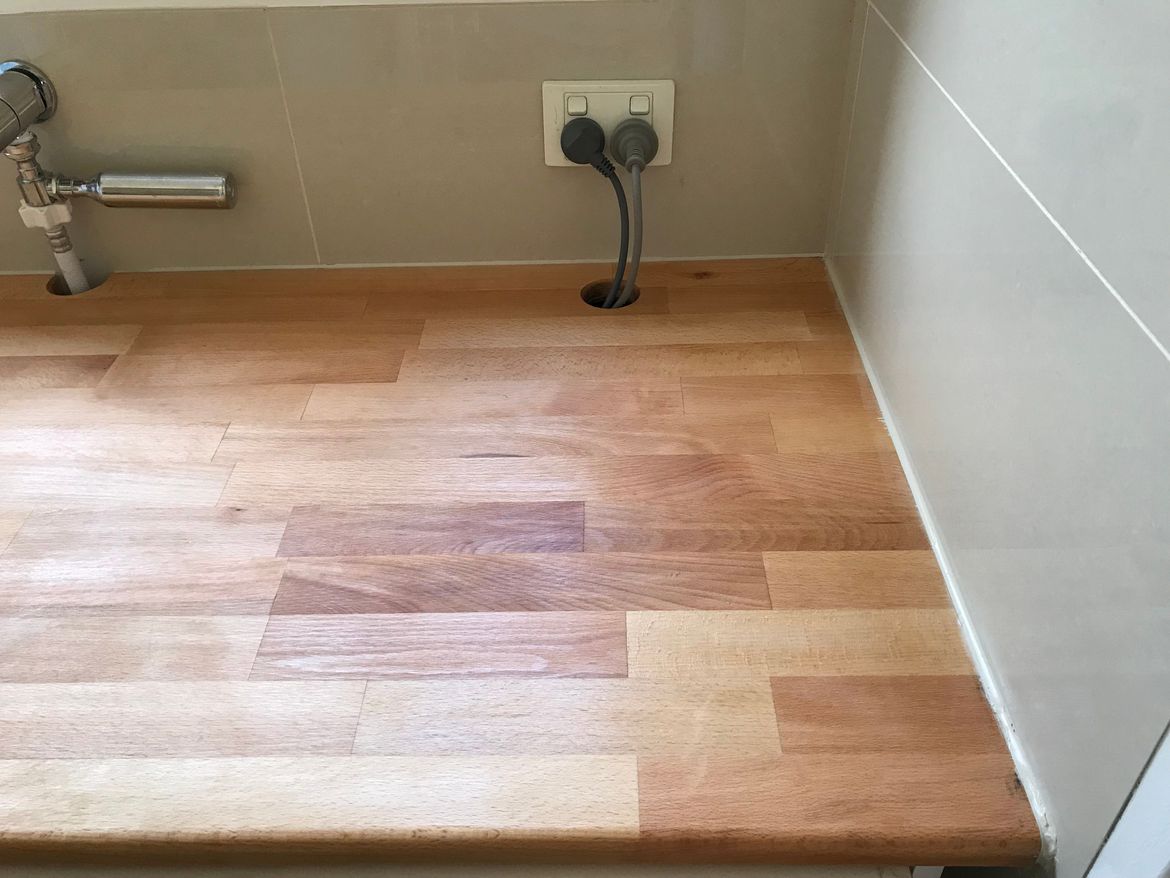

I ended up locating the stub next to the power outlet and calculated the rest stubs, I used 3 hex head screws to attach the steel angle
to the stub and they are quite strong. For the right side wall, I used two tox wall plugs as it was tricky to find stubs but they are strong enough.

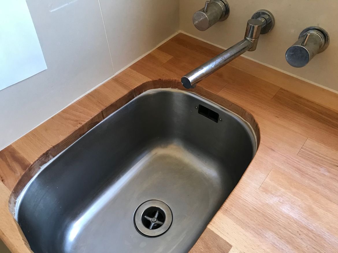

I kept my existing basin and cut out the tabletop to fit its shape. That process is a bit challenging and I will need more practice using a jigsaw to cut the curve. As you can see, the details aren't very smooth but I'm happy this time

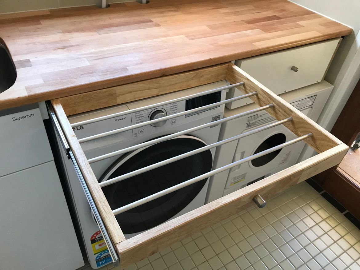

The timber I used is a 26mm beech panel and I finished with two layers of Feast & Watson wipe-on poly. I added a built-in drying rack in the middle of the build and I think it looks quite neat in a tight space.
The cutout of basin requires more practice, cutting the curve with jigsaw is not easy for me.
Built in drying rack
