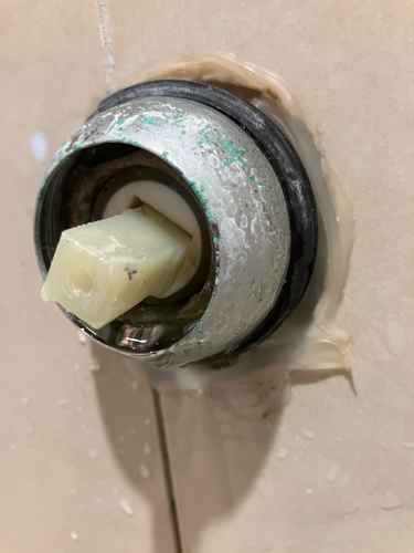

In the process of removing the cartridge, I am having difficulty removing the ring encompassing the cartridge.
Please find the photo attached.
On the photo, there appears to be a white and cloudy material (wax or hot glue gun, not sure) surrounding or sealing the ring.
What should I do to remove the cartridge that is stuck within these rings?
I would appreciate your support.
ring surrounding faucetring surrounding faucet
white wax or material around the ringwhite wax or material around the ring

I was able to remove Part 4 (cartridge dome) but it is difficult removing Part 5 (cartridge locking nut).
It is very rusty by the looks, I have tried using some tools and applied WD-40 lubricant to turn it anti-clockwise and vice versa which worked a little.
Do you have any ideas or recommendations to remove the cartridge locking nut?

My only advice would be to use a bigger adjustable spanner or pipe wrench @plum25. Those nuts are typically quite tight. If you are close to putting all your strength behind the wrench and it's still not budging, then I'd call in a plumber. It's at that point that you could potentially damage the plumbing work.
Re: How to DIY fix a leaking shower faucet?
Afternoon @plum25
Yeah my next steps and then recomendations if they didnt work would be to head towards a plumber as well. No point in pushing your luck and ending up with a larger bill 😕
