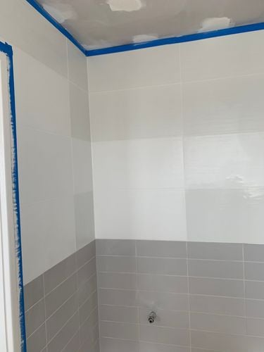

I’m in the process of renovating my bathroom. This is the final week of the Reno, but I just realised the shades of my bathroom wall tile is different, The tiler and I both didn’t check the codes of the tile, and the tiler laid the different batch of the same tile on the wall.
The builder said they will remove the tiles and patch up waterproofing and relaid the correct tile. My concern is if they do that, it will most likely damage the waterproofing in the shower area (photo 2: Two tiles near the Niche). Is the waterproofing going to work for a major wet area?
This is a lesson learned for my first Reno, I should have check the tile. Please let me know if there is any suggestions. Thanks in advance.

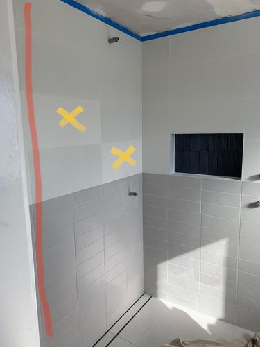

There are 2 pieces of tile (yellow cross) in the shower area need to be removed, and the redline indicates where the waterproofing ends
The tiler actually did the waterproofing, so I want check with them regarding warranty.
Re: How do you replace tiles without damaging waterproofing?
If only two are being taken off perhaps your tiler will be able to remove them without too much damage to the waterproofing.
