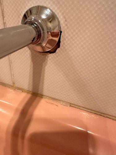

we just had the bath wall set replaced but there is now a small hole around the tap- see pictures

However, one way to cover the gap is by using Parfix 500g Ready To Use Multipurpose Filler. This product dries hard and can be used for indoor or outdoor repairs. Your objective is to use the filler to cover the gap at the same level as the tile. I suggest using a Pro Renovator 50mm Plastic Scraper to prevent scratching the tile. This will save you from having to sand down the excess filler.
Another method is to use a Kinetic 295 x 210mm White Flat Self-Adhesive Cover Plate. This is a laminate plate that can be cut into a circle to the size that you need. You then stick this right over the spout so that it covers the damage. However, silicone must be applied to the outer and inner edge of the laminate cover to prevent water ingress.
One more way to cover the damage is to use a Kinetic Cover Plate. The come in various sizes, I therefore suggest measuring the size of the flange of the spout and compare it with the cover plates available at the store. I suggest using silicone to attach the plate to the tile wall.

My first question is "Did the plumber leave the tap that way?" If they did I would sugest to get them back to fix the issue.
If they didnt or it will be too much trouble (Been there before for sure) then I would go down the path of a cover plate that @EricL has mentioned that fits between the wall and the tap itself (You will need to under the neck of the spout is all)

The plumber did leave it like that but like you suggested it’s too much hassle to ask him to come back - so will ensure I measure correctly so that I purchase the correct size cover plate is used
