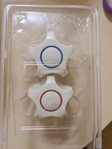

Our bathroom's tap is broken and would like to replace it myself. I am not sure how to remove it and replace it with a new one. I have attached the broken tap and new tap images. I would request you guys to please help. I also have WD-40 if it will help.

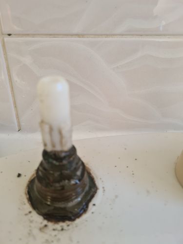

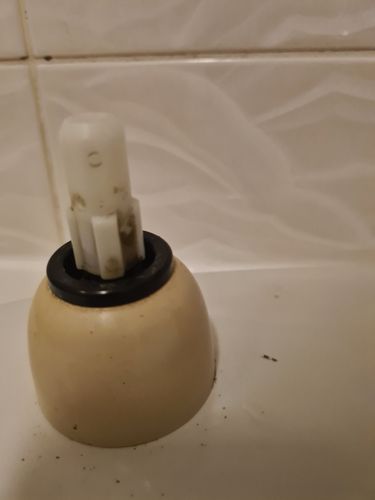

I have removed the cover plate. But I dont know how to remove the white cover on the spindle. Or should I not remove that cover?
Please check the image below:

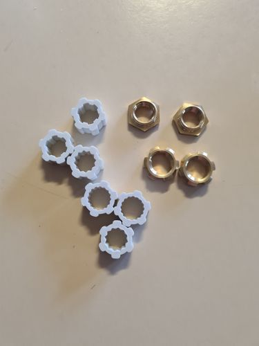

Hi Jacob,
Below are the accessories that come with the new tap handle.l:

I used to have the handles seen packaged in @fidakd's photo above. And from memory, those plastic wall flanges you mention are required, but also the spindles that have thread on the handle end.
Something like a Stanley knife gently pries off the inner white caps and removing the red and blue inner rings allows a socket to fit the two nuts seen in the top right of the photo above. Working against the spring, you tighten the handles into place with the nuts and once secure, replace the rings and caps.

I am thinking that you will have to change the whole spindal as well. The old spindal looks like its been made for purpose and the new taps are "most" purpose fittings (replaced similar ones that were broken with the new ones you have) I would wait for @JacobZ to get back to you but wont be surprised that you may need new spindals. (They are easy to do, you already have the hard work done as we can see the large nut on the spindal in your last photo)

I can't say I've come across a spindle with a white plastic top like this before. I'd hazard a guess that the white plastic piece is removable to reveal a metal spindle with a thread beneath, but I'm not 100% certain of this so please hold off until I can be certain.

Those white plastic fittings should pull off. You might need to place a timber block on the bench and use a large flathead screwdriver to lever them off. Once removed, they should reveal a standard spindle, which you can use the kit on.
If you do need to replace the whole spindle, then these basin spindles are what you need. Check the depth on the current one and match it up.
