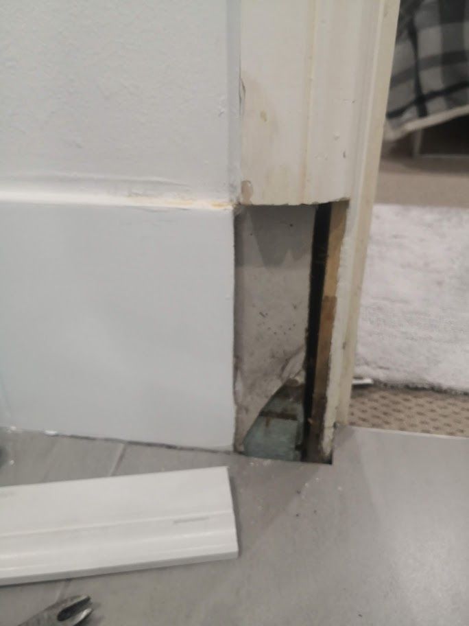

Hi all,
Hope everyone is having a very productive DIY weekend.
I need some help/suggestion on how to fix this rotten door moudling in the bathroom, think due to water damage when we purchased our house.
Thank you.
Hi @stelz,
I'd suggest you start by using a chisel or flathead screwdriver to dig out any loose, crumbly or deteriorated timber. Chase the damaged timber until you reach a solid section that you start having issues removing easily. Once you have reached solid timber, spray the area down with Earl's 250ml Wood Hardener. This is a fantastic product that binds and solidifies the remaining timber. Once this product has dried, you can start to fill and reform the area with Builder's Bog. Once the bog has dried, you can sand it flat, prime and paint. Alternatively, you could cut the section of timber out and replace it with an equivalent piece. However, you might need to do some work to get the new piece of timber to fit correctly.

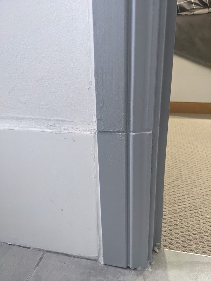

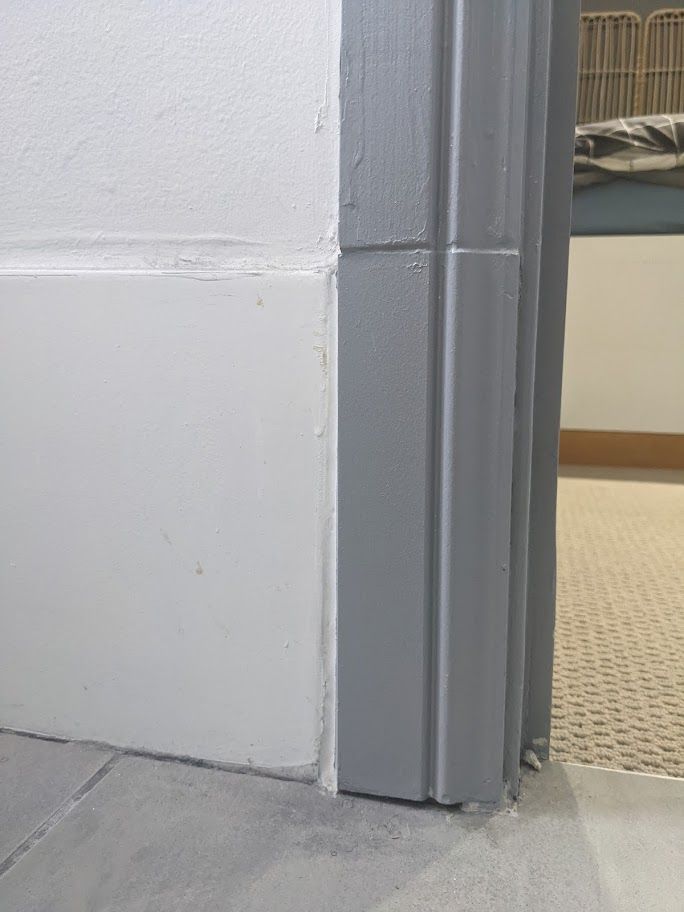

So as @MitchellMc suggested, I used the chisel to remove and dig out the deteriorated timber. Then we clean out the area and match the old section with a new timber door moulding as best as we could. Lucky us, we did not have to do much adjusted to fit the new moulding in. I used a gap filler to fill in the joint as much as could, the painted . Much cheaper then removing the whole door frame. I am happy with the end product does the job. I hope that helps
The process
The finishing result
Hi @stelz , wow, the end result is so neat & clean. Thanks a lot for sharing this! This is really what I am looking for to fix the issue.
Hello @stelz
You've definitely "Nailed It" that's an excellent repair job and the paint looks great. My only other tip is to put some wet area silicone in the gap between the floor and the door moulding to prevent water from entering the gap.
