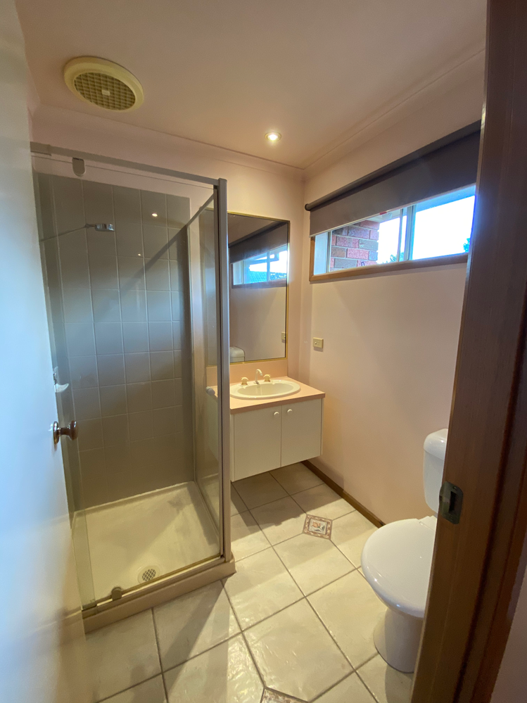

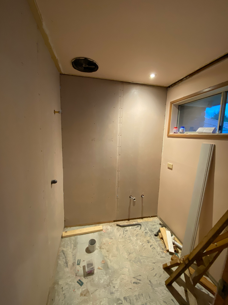

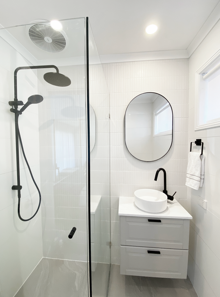

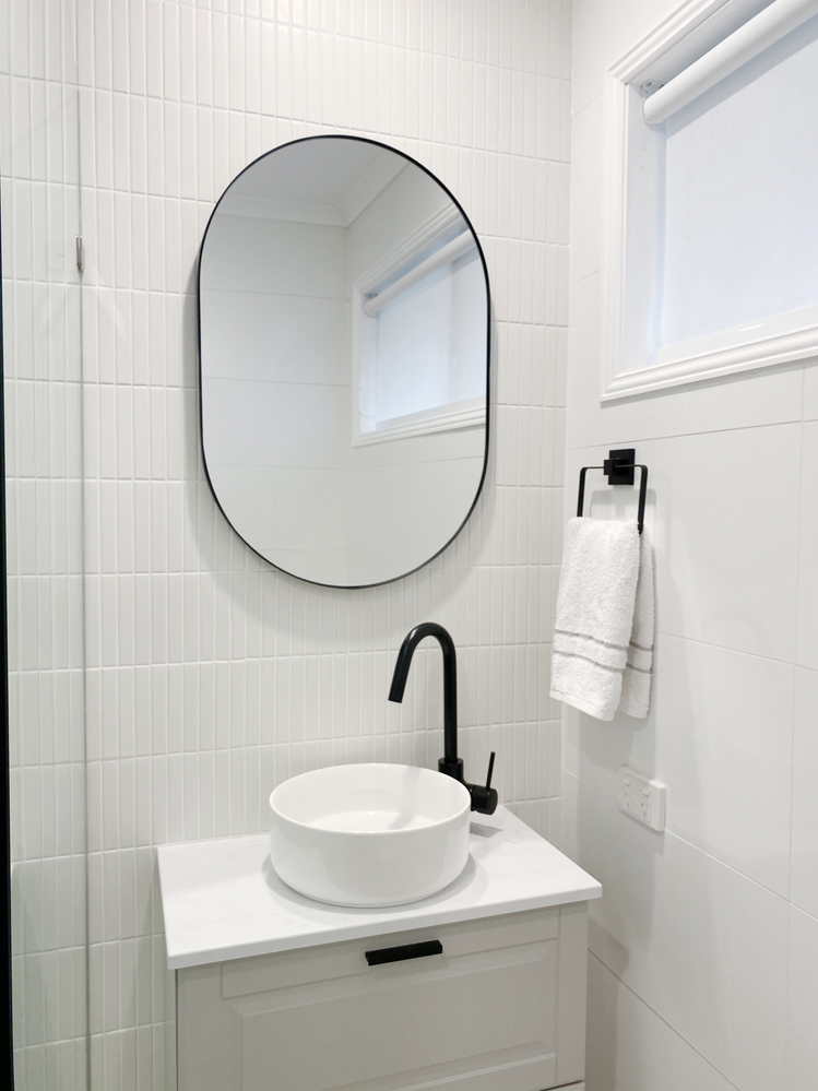

Our first big DIY project was to renovate our ensuite bathroom. We did everything ourselves from demo, re-lining the villaboard walls, screeding, waterproofing, tiling, installing new cornices, painting and installing all the fittings and fixtures. We wanted to achieve a light, bright and clean look as it is a small bathroom so we opted for all white tiles on the walls and a grey large-format floor tile. To keep consistent with the matte black tapware, we opted for matte black finishes on all the other bathroom fitting accessories (toilet flush button, toilet roll holder, hand towel holder, shower caddy, shower screen knob and the vanity drawer pulls).

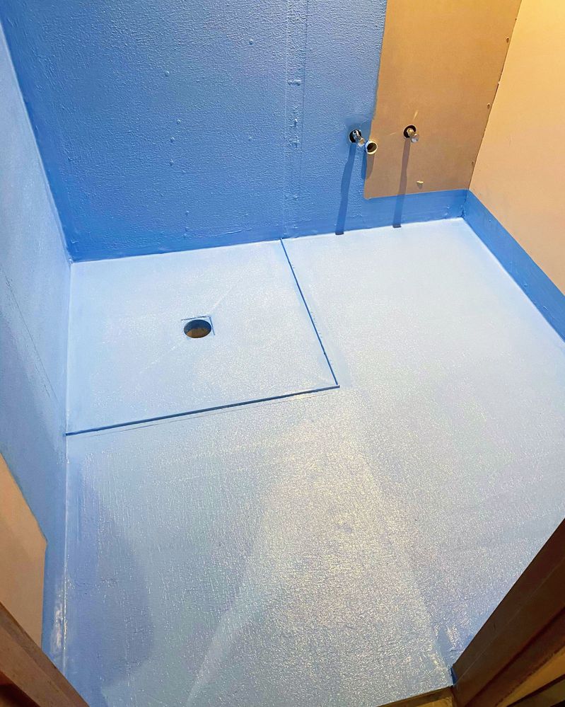

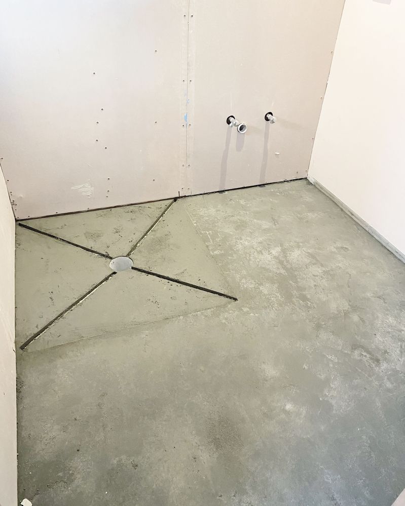

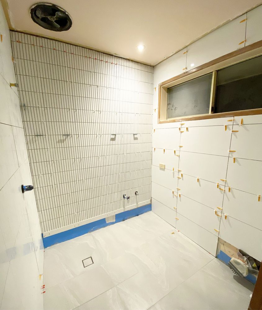

Finished Ensuite RenovationFinished Ensuite RenovationFinished Ensuite RenovationFinished Ensuite RenovationFinished Ensuite RenovationFinished Ensuite RenovationEnsuite Bathroom BeforeEnsuite Bathroom BeforeRe-lined walls with Villaboard following plumbing layout changes.Re-lined walls with Villaboard following plumbing layout changes.Bonded screed laid to raise floor level to allow for falls to waste in shower.Bonded screed laid to raise floor level to allow for falls to waste in shower.Under-tile waterproof membrane to floor and shower recess with waterstops.Under-tile waterproof membrane to floor and shower recess with waterstops.Wall and floor tiling with large format and mosaic.Wall and floor tiling with large format and mosaic.

Thank you very much for sharing your ensuite bathroom renovation. What a fantastic D.I.Y. effort, you must be very happy with the results. Looking at the photos it is a very small bathroom, but with the tile colours you've chosen, you've definitely achieved that light, bright clean look. It looks so much bigger and gives off a very relaxing vibe. It is a world of difference when you compare it to the old look you had before.

Glad to see you extended the waterproofing membrane beyond the shower area and I can't quite see with your pictures but I think you have created a stepless shower in the process? There simply is no need to have a step into a shower if the drainage is done correctly and it looks so sleek, well done and welcome to the community.

Hello again Barbara! @Baretta11Thank you for your lovely words of encouragement! Yes, it is a stepless/frameless shower.

hello, can you please let me know what basins you used in this reno.  They look great. thanks
Re: Ensuite bathroom renovation
Hi @natalia1,
It is the 'Allure' above counter ceramic basin from Timberline. 😊
