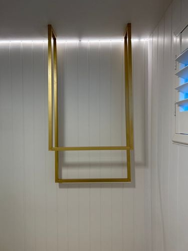

Brushed gold ceiling mounted towel rail.
I love the look.
I used:
2x 600mm
2x 900mm
2x 1.2m
2x 300mm which I cut in half using a mitre saw but you could use a hand saw.
Using a rubber mallet, I placed the Metal maté connectors in place.
Very lightly sanded the towel rail & applied 3 coats of White Knight Gold Satin spray paint.
The towel rail needs to a screwed into timber & as this was a total renovation, I pre planned this.
I used snap on screw caps to hide the screws & hand painted them with the gold satin spray paint.
Materials
Tools
25mm x 25mm anodised aluminium tube, in various lengths
I/N: 1130464
Metal mate connectors
I/N: 1138482
I/N: 1560615
Snap on screw caps
I/N: 0035559
