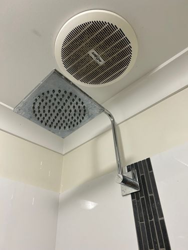

  Hi everyone! Newbie here 😊
I was hoping to get some advice around whether it would be possible to change my current rainfall shower into a handheld shower myself at all? Or whether I would need to hire someone to do it.
I’ve attached some pictures of my current shower!
Thanks!

Thanks Jason! I’ve had a look at them before.
I guess I was more looking at whether I would be able to detach it from the wall and go from there, but I have no idea how to disassemble it from the wall to install a handheld shower! 😂

Hi @ypcme
I suggest running your fingers around the mounting post of the shower arm. Somewhere along there is a small hole with a grub screw that's holding the shower arm assembly in place. Once you locate the grub screw hole, I recommend using an Allen key to remove the grub screw and pull or turn the entire shower arm assembly.
The chrome piece that is protruding out of the wall can either be turned anti-clockwise or pulled off. Please have a good look and give this method a try. My best advice is to not use any excessive force when taking this shower assembly apart.
However, if after a lot of searching nothing reveals itself, I suggest engaging the services of a registered plumber.

Hi @ypcme,
As @redracer01 has mentioned, the assembly on your wall likely unscrews off. Have a look for the grubscrew mentioned, but also try gripping the entire showerhead/arm and gently rotating the whole assembly anti-clockwise. It will likely unscrew from the wall, leaving an exposed threaded copper pipe. You can then follow this guide: How to change a showerhead.
