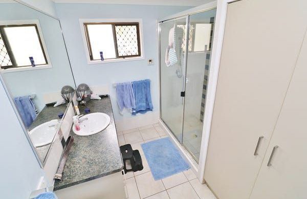

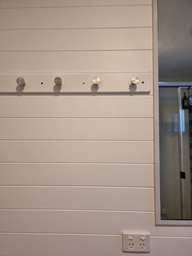

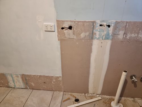

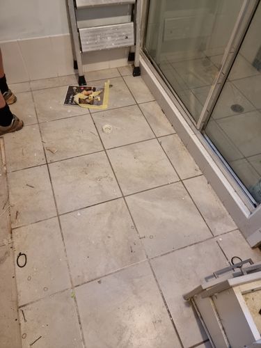

We started our reno budget today. Just ripping off tiles and smoothing wall down to put VJ panelling over. Then we were going to lay our hybrid waterproof planks down..but then we found there is no waterproofing on walls and floor..so floor and everything else is on hold til tomorrow. Won't be able to put vanity in until someone can help my partner get off his ute.
Am wondering whether to paint the cupboard doors next to shower with my white laminate paint.
no drain in floor either..Lucky we ripping tiles up and can put one in tomorrow.
I've spray painted the mirror edge white and the window.

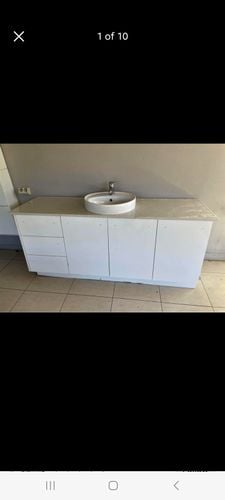

We brought this vanity with stone benchtop $300 off facebook..just gotta fix the base underneath.

You might have already seen it, but there is a specific VJ panel for wet areas. The normal version can deteriorate in moist environments.

Thanks Mitch for the information on the vj panelling..did not know there was wet area panelling. We did waterproof under panelling so far and where the tile has been cut for vanity base. We won't be running the waterproof laminate flooring through, just going to keep the outdated tile for now
