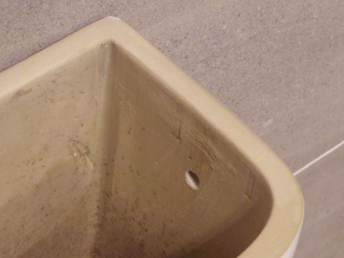

Yay, it's done! For a 6mm pipe I decided to use an 8mm drill bit, which gave a perfect fit. 6mm would have been too small.

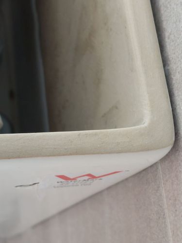

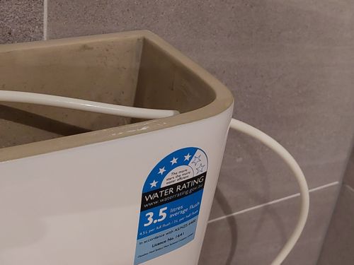

Had I been even more patient, used a lower torque setting on the drill, and not applied occasional force I could have had a cleaner hole on the outside. It was very fulfilling to see the drill bit come out of the other end after more than 15 minutes of drilling.

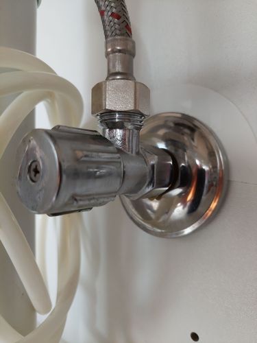

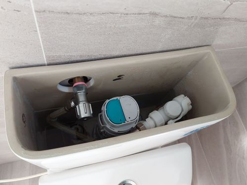

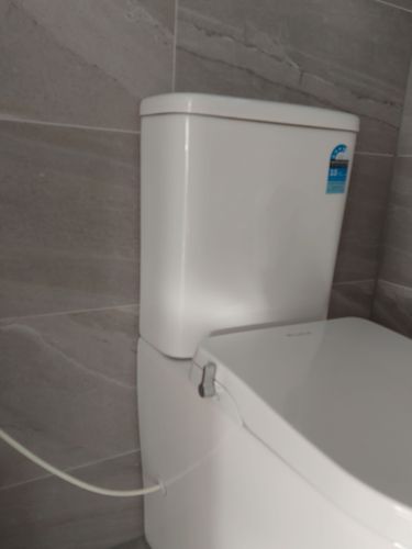

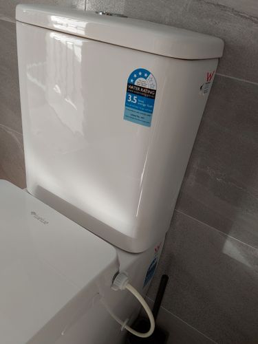

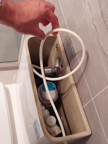

Hi Eric, please see attached images of the  3-way connection- one inlet and 2 outlets. The 3-way connector was supplied by the Sydney- based bidet distributor after I told him about the available water source and what I wanted to do. Happy to send any other information you or others may need to install a bidet.
