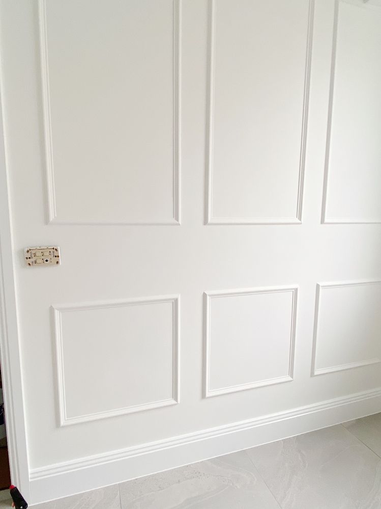

In the main bathroom, we decided to leave one wall un-tiled and add some wainscoting. We demolished the bathroom as part of the full bathroom renovation and re-sheeted the one wall with new plasterboard. After patching and filling the plasterboard screw holes and joints, we measured out the wainscot design leaving space in the middle for a towel rail. We cut the timber moulding to length and used a brad nail gun to shoot on the timber moulding and skirting. Finally, we caulked, primed and painted the wall. A fairly easy DIY project that adds a bit of character to what would have otherwise been a plain white tiled wall. ☑️

Finished Wainscot Feature Wall

Did you glue the moulding on at all, or were the brads sufficient for holding it in place?
Many thanks for sharing, and great work!
Thank you so much @MitchellMc! Yes, apologies, I must have forgotten to add that step into the post. We applied liquid nails to the moulding then shot the moulding on with a brad nailer.
