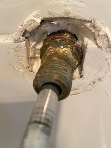

My problematic tap in a place I recently bought has finally stopped turning even without a wrench, which means I can’t access cold water and since I can’t change temp
of hot alone, can’t shower! Argh.
Seems to have been done badly, with the base set into the tiling and also not centred, making it currently impossible for me to turn it to change the washer (hoping that fixes it).
No expert here but think it’s Brass too, so any tools I use are somewhat threading or at least damaging it. Tried to budge it and I can’t.
any advice very welcome please as ideally I can fix it myself, but also can’t get a plumber out for 5 days anyway (by which point my hair will be stuck to my head).
- any advice on best tool to get that thing off?
- would WD-40 help? I don’t have any but happy to visit local Bunnings
Any other advice? I’ve also bought this pack so hoping it’s the solution but if anyone knows more, appreciate it.

There's a good chance that it has locked up due to scale buildup over time or overtightening upon install. Applying WD-40 will often help to loosen things up a bit and unbind the threads. I'd suggest soaking the base of the spindle with WD-40 using the straw attachment to direct it as close to the connection as possible. Let it sit for 5-10 minutes to allow the WD-40 to do its thing.
You should then use either long handled multigrip pliers or a long-handled pipe wrench to tightly grip the hexagonal nut section of the spindle (near the red washer) and rotate the spindle anti clockwise. The longer the handle, the more torque you can apply to rotate the spindle off.
You should also get some benefit from applying percussive force by tapping the head of the wrench with a hammer while you rotate.

Thanks all! I got some WD-40 and a multi fit tap spanner set from Bunnings but even after spraying it 4 times it out WD 40 and trying lots of ways to get it to turn, it hasn’t budged even a mm.
any other suggestions? I will try heat it with my hair dryer tomorrow but just don’t get the sense it wants to move at all.
