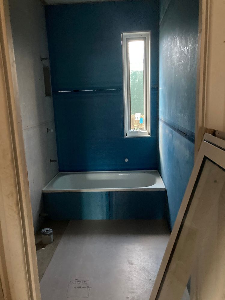

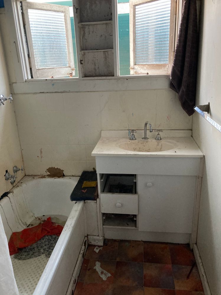

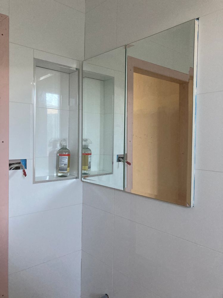

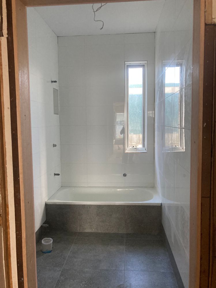

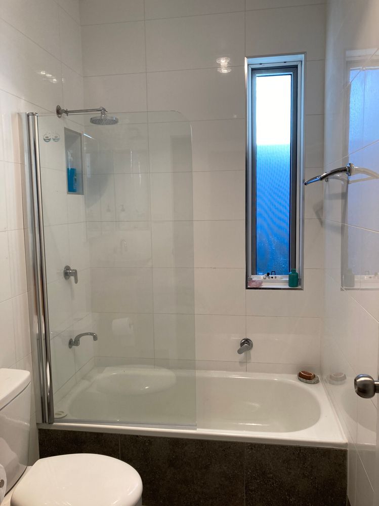

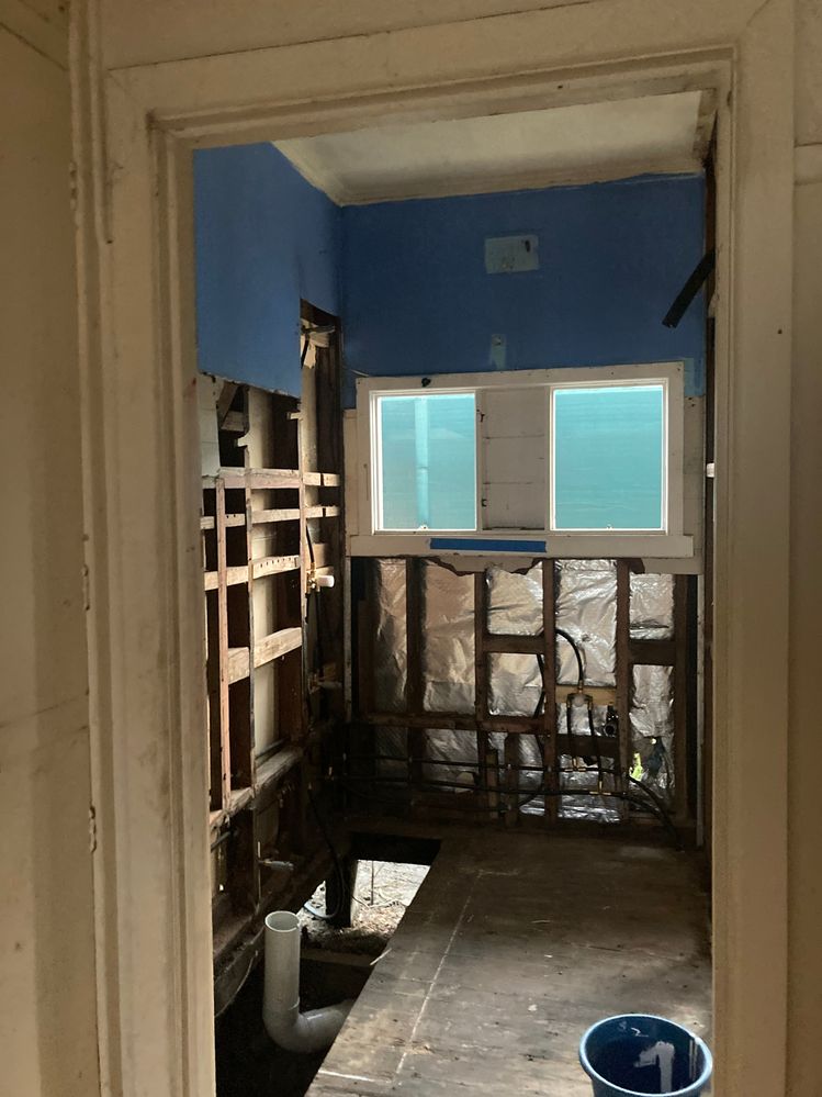

This Bathroom came from a house that should have been demolished...  instead , I could see the potential, and she had good, strong hardwood bones.  So to get started,  electrical  wiring and points all removed, (by qualified electrician),  demolition derby began with a big sledge hammer , and EVERYTHING straight to the skip bin and renovation took place wearing mask, goggles , overalls and a big peg on my nose !!  Old wet mouldy plaster taken out and the moulded ceiling removed.  You can clearly see the state of disrepair !!.   Then with 1 full skip bin of rubbish removed, ( unfortunately nothing could be recycled or reused, the slow and arduous 8 month process of getting the bathroom reborn began.  First  a complete new rewiring, new cement sheeting  on the ceiling, floor and walls  along with waterproofing. Inserts were left for the vanity and storage area in bathroom and shower.   I managed to find a fantastic old enamel bath , that I made to fit and only 168 cm wide, it was tight into the bath frame. This is a super small room 168 cm x 265 cm  and i've made it look really large as well as fully functional. A bath was a must have, so I made it an over shower so it was duel functional for those get ready to work early mornings !!    New lights , heater and exhaust fan , gorgeous tiles from Bunnings on the floor and walls installed and a new long slimline  wind out custom made hush, opaque window was put into place.  I custom made the bathroom cupboard from the recycled kitchen drawers and then used marine ply on the bench top.  I sourced a beautiful marble basin from Bunnings. along with the basin and shower and bath  taps and hardware . On went the new door, shower screen and final touches. This bathroom renovation took almost a year. Most materials, tools and equipment was from Bunnings , which as easily sourced.   I'm ultra proud of my dedication and  persistence to bring this bathroom once relegated to a demolition, into its new purposeful new life. :smile:
