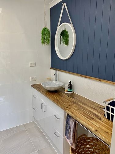

Very pleased & proud of how this room turned out.
Took a couple of weeks to complete, lots of evenings & weekend.
was on a strict budget and wanted to get the look for less
Bought everything from Bunnings (of course) & made smart choices with materials and products.

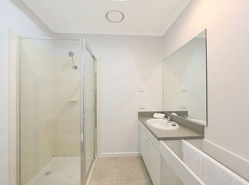

Too save money and to reuse/recycle, we kept the shower base & screen

Classic white 300x600 ceramic tile
Textured white 300x600 ceramic tiles
Crema 600x600 floor tile
Estilo Toilet
Estilo shower head & taps

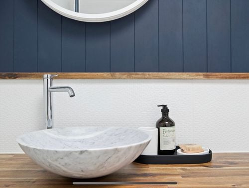

Acacia Project Panel used for benchtop
Mondella Marble sink (on clearance)
Olivieri tap (also on clearance)
Pine VJ panelling
Porters Paint - Yacht Race

With such a small budget I calculated every single thing we needed, even down to the tile spacers and if we had to buy a tool or a drill bit that we didn’t have.
I achieved all this for just under $2,000!
Mind you, I did get an absolute bargain clearance price on the sink and tap. But without the clearance price I’d have still been under $2,500!
My trick to get the look for less was to use the basic white tile to keep thing fresh and to use other materials that are cheaper, but give a great result ☺️

Exactly what I was thinking of doing. Can I ask how much gap you allowed between the panelling and the tiles and the panelling and the ceiling cornice? Also did you attach directly to the existing walls and how did you cover any gaps?

The panel was cut to fit as close as possible to the tile and cornice.
I actually painted it before it went up. That way I could get the edges perfect.
As it fitted the space there were no gaps to fill, except the pin holes from the fixing gun & I just used an interior filler.

The mirror is actually from Bunnings. It’s 70cm and I think it was about $75.
