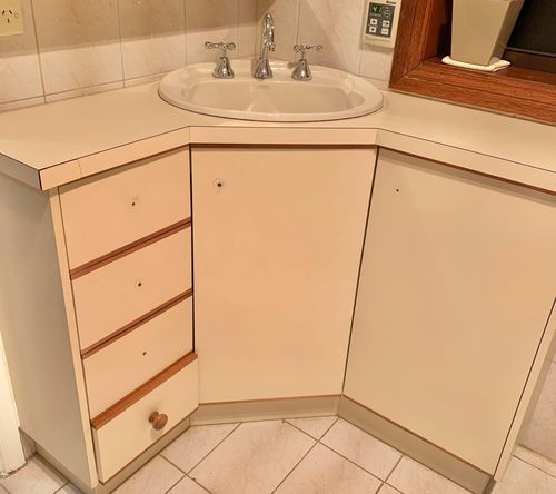

Bathroom cabinet refresh using the Dulux Renovation Range. Colour is Ticking #diyjuly

Amazing result! How did you prep the counter top and doors? Thanks in advance

Thank you! First time doing anything like this so I just followed the instructions to the tee. The videos are great because they show you what products to use too. Good luck!
Thank you. I just followed the instructions and the Dulux videos are great because they show you the products too. I scrubbed and scrubbed everything and twice and then used the mould killer and then scrubbed and rinsed again. This bit takes the longest but the most important. I had a couple of spots in the corners where I must not have got to all the grease and you can see it. As it comes through, even with multiple coats to try and paint over just that spot. So take the time to clean. I did the cleaning and primer one afternoon. Then left it for 24 hours and then painted coat 1 then waited another day to paint coat 2.

Congrats, great job, looks terrific! i need to do mine which are a ghastly pink colour in both the ensuite and main bathroom could you pls tell me how hard it was to paint around the Sink? Thank you Evie
Hi @NanaEvie
Let me tag @jonalissa to make them aware of your kind words and question. One way to make the painting around the sink easier is to mask the sink and the corner wall with masking tape. This will let you get as close as possible to the sink and you can get into the very tight corners of the vanity without worrying about paint going everywhere.
