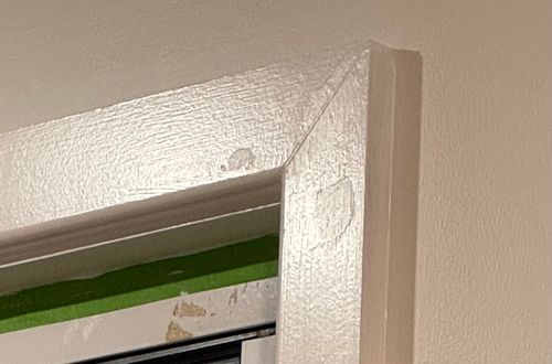

I have recently painted door trim with water based semi gloss enamel and can see, quite obviously, that I hadn’t sanded the gap filler enough off the nail holes. How long do I need to wait before I can sand it back before re-applying the next coat, and what grit sandpaper would you recommend? Should I sand the whole door trim to ensure an even finish, or can I spot sand the nailed areas?

You'll want to wait at least 2 hours before doing anything to your paint.
After this waiting period, use some 180-grit sandpaper to sand the paint back and smooth your patches.  A light sand of the entire surface will be beneficial but not 100% necessary. It will be fine to spot sand in this area.
Once sanded, brush away any sawdust or powder residue before proceeding to your next coat of paint.
