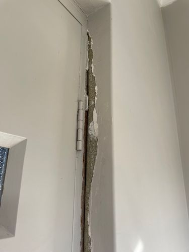

I am wondering how to fix these damage bits of plaster coming off the wall in the two pictures below.
the second picture is next to the entrance door way where high movement occurs, the plaster sounded loose so I started to remove it.
i don’t think the spackling pre mix would do the job here so I’m wondering if the following solution could do the trick:
brushing area back to the bricks,
applying a primer then under coat plaster and finish with skim coat? Or is it a bit overkill and a pre mix compound could suffice? So many products out there!

It's a bit of a tricky spot because the door being hinged off that side of the jamb will put force on the frame that has likely caused the fracturing of the plaster. The issue with using a premixed compound is that they don't give as much strength as a powder base coat compound. The base coat dries chemically and gives the majority of the strength in plasterboard jointing systems.
To give the strongest fix to the gap near the door, you will need to follow a few steps to give it as much strength as possible.
It looks like you've removed the vast majority of the loose material near the door, but if there is any more that feels loose, remove it.
Apply a coat of Gyprock CSR Base Coat 45 to fill the gap. Make this coat flush with the existing plaster, then apply some Fibreglass Joint Tape once dry.
Then apply another thin coat of base coat to encase the tape. This will give the join between the old plaster and the new plaster as much strength as possible.
Once this second coat is dry, apply a skim coat of Gyprock Less Mess Topping Compound which can be feathered out thinly to smooth the transition to the other plaster.
When everything is dry, sand smooth with a Trojan 120 Grit Angled Sanding Sponge and then paint to match the surrounding plaster.

My only concern is that those products are indicated to work for drywall/gyprock wall whereas I have bricks behind the plaster - would that still work fine?
Also it seems that only the skim coat came off, the base coat is still attached on the brick which doest leave me much room to apply base coat + skim coat on top - should I scrap it all off and grind back to the bricks?

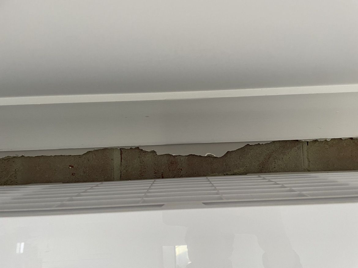

The area above the A/C seemed to have lost all layers of plasters though thumbnail_IMG_6606.jpg

When plastering directly over bricks, the best product to use as a first coat is Gyprock CSR 20kg Hardwall Plaster, which needs to be mixed with Dingo 20kg Hydrated Lime.
You shouldn't need to remove all the existing plaster. I'd suggest using a straight edge and a utility knife to score a straight line down the centre of the wall. Remove the base coat back to the bare brick on the left side of your score line.
Once the old plaster is removed, fill this void with the hardwall plaster. Allow the first coat to dry, then apply the tape and a very thin second coat. You are going to have a very small hump where the mesh tape is, but the tape is designed for this hump to be as thin as physically possible.
You should then apply the topping compound over the whole wall, stopping around 20-25mm back from the outside corner. This coat will conceal the hump where the tape is and by skimming the whole wall, there will be no obvious variations in the depth of the plaster.
You can use the same process above the air conditioner.
