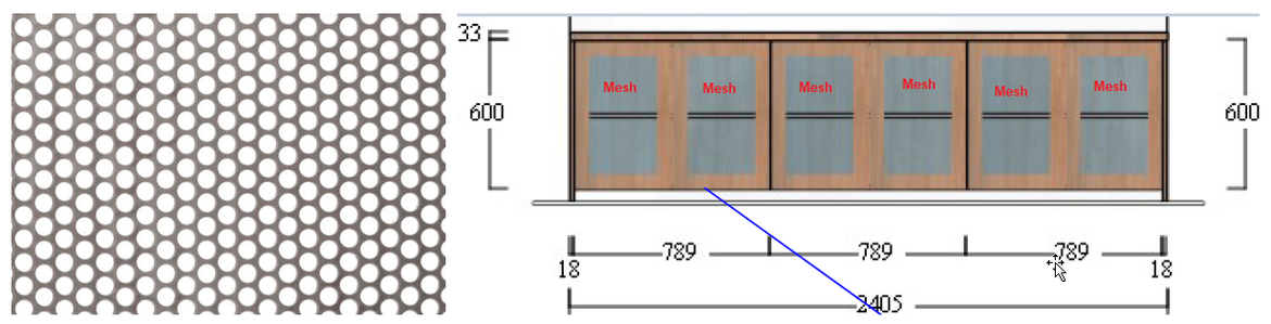

Would steel mesh on an entertainment unit affect sound quality?
Planning to do below table for speakers with steel wiremesh door.
Anyone did stainless steel wiremesh door for speaker table , will it affect the sound quality?
Below is the mesh product link:
https://www.sanao-wiremesh.com/products_detail/19.html

If you are placing the speakers inside the cabinet, it will act like a baffle and make the sound muffled. I don't think the the mesh will help and possibly trap the sound even further. I don't recommend putting the speaker inside the cabinet.

Hi @Samara1 as cool as the design is I would have to agree with @EricL that if sound quality is at all important it will be totally lost with this concept. There are so many influencing factors purely by position within a normal environment let alone inclosing them within a metal mesh fronted cabinet.

as per previous posts the quality of the sound output for any speakers within the cabinet will be compromised. I would consider placing the centre speaker on top of the cabinet and the sub externally off to one side if you want to maximise their effectiveness. Ultimately it comes down to personal hearing tastes. You may be perfectly happy with how the system sounds with internally positioned speakers and thats really all that matters.

The steel mesh will definently impact the sound quaility, anything really in front of the speaker itself will cause bounceback, muffel the sound.
I would still go with the black lightweight material cover I suggested as a best option.
On a side note, the any steel covering will definently effect the ability of a remote to control what is in the cabinet. Maybe you could leave one section "open" so that wont be an issue.

With you having doors in front of the centre speaker only adds to the problem..

Where that cutout is on the doors shown as mesh..It can only be a grill cloth material stretched across the openings..If you don't have access to grill cloth, then you use an acoustic polyester fabric mesh material..available from Spotlight or any similar store...You may even be able to get it in different colours if you don't like black...
When you buy the speaker..the first thing to do is remove the grill cloth frame assembly..
When you put the speaker in the cabinet, have the front of the speaker right up against the cloth on the cabinet..and sit the speaker on some foam rubber..
All of that should give you the best possible sound as much as possible..
