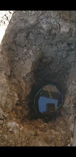

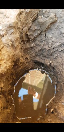

I dug up post holes in my backyard for a pergola. 1 post hole close to the wall keeps filling with water.
I dug up 600mm and since i was close to the wall i exposed the edge of the black plastic under the slab. Water seemed to be seeping from under that plastic. So i put my finger in the area and i was able to remove the soild and make the whole bigger. It fills up in couple of hours.
I dug very slowly because i didn't wanna hit any underground pipes since i was digging next to a gutter pipe and only used a round post digger and small crow bar. I can't see how if i damaged any pipes because there are none there.
Now i am worried if there is a potential problem under the slab.
House is in Mickleham and it is only 3 years old. Should i be contacting the builder or a plumber or just go ahead and fille up the concrete.
Images attached.

I'd recommend you take a picture of your water meter reading and not use any water in the home for a few hours. Go back and check the reading. If it's increased, you'll know the water is coming from the mains, and you have a leak. If it has rained recently, this could just be subsurface water that is sitting on a clay layer. It's a bit peculiar that it appears to be coming out from under the slab and I'd suggest it might be an idea to enlist the services of a leak detection specialist.

Coming form under the slab, it may be an idea to get a plumber out to have a look. I couldnt comment about your warranty (It should be in your paperwork somewhere)
