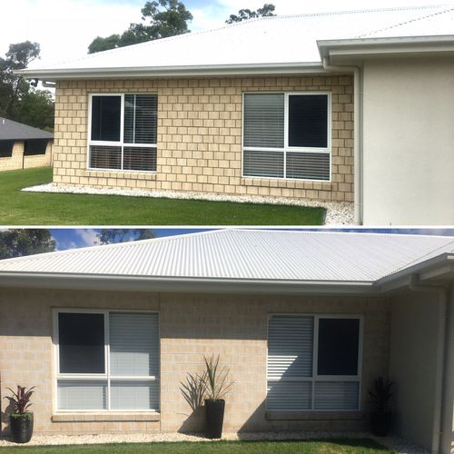

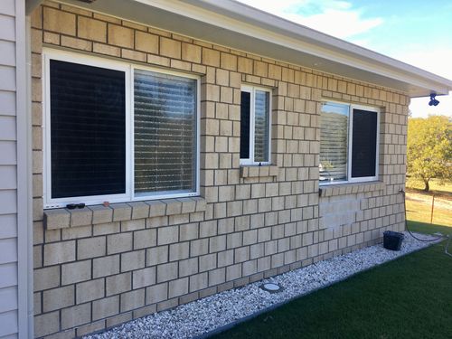

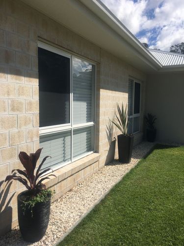

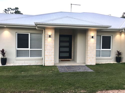

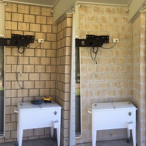

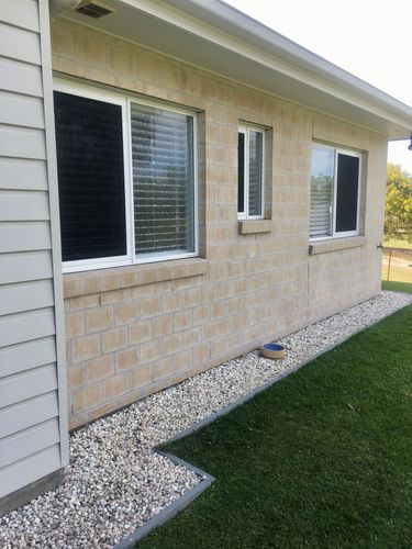

Using 6 $11 bags of white grout from Bunnings, I transformed the aesthetic of our house. Unhappy with the dark grout our builder used I set out to research cheaper alternatives and methods. Here is my version of German Schmear 👌🏻

Hello Katie ☺️
it took me approx two weeks on and off, I did about 2 hrs at a time. Very easy process just time consuming. Definitely tackled in sections.
Re: White grout transformed house aesthetic
Thank you, no I didn’t take the original grout out. It was very deep set and I wanted it flush with the brick also. I cleaned the grout first, waited days for it to dully dry then started to fill in sections 👌🏻
