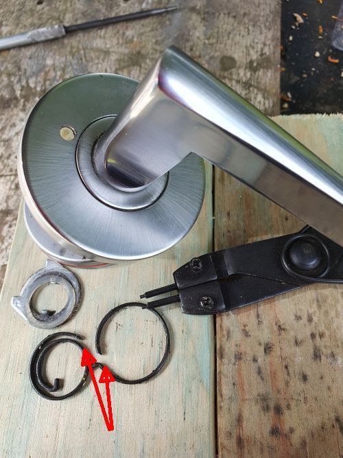

But yesterday I noticed the toilet/bathroom outer lever was looking rather limp and would not return to the horizontal position when released.
A quick autopsy revealed the lever spring had snapped.

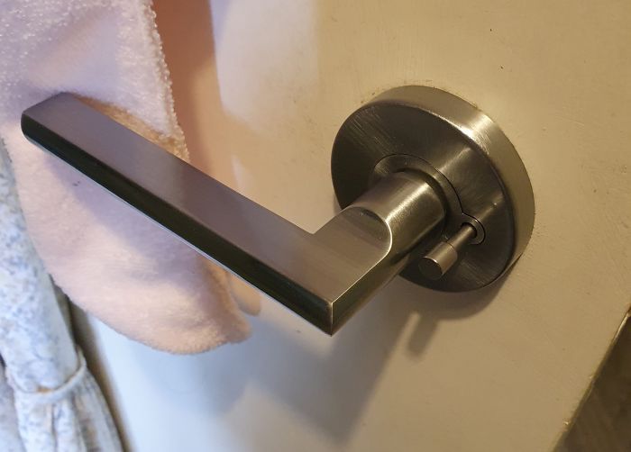

I'm really thrilled with this leverset. Much better construction all round compared to the Lane.
Better rosette cover that self-centres due to the locking pin surround.
Much sturdier locking pin and locking mechanism.
Much better fastening system. The Lane had a fiddly threaded tube system.
And a very clever square drive spindle that locks into position with a depressed button (No.11). Much better than the springed version on the Lane that flys off when attempting to assemble.
Similar lever spring to the Lane so I suppose it could break just as easy as the Lane - time will tell I guess.
But, overall, I'm glad the Lane broke. 😁
The finished look...

Thank you very much for sharing that lever set replacement project.  It is a common point of failure with lever sets in general that the return spring will either bend out of shape or snap in the middle. I reckon it is the sudden force of twisting that shocks the spring and stresses it out to failure.
