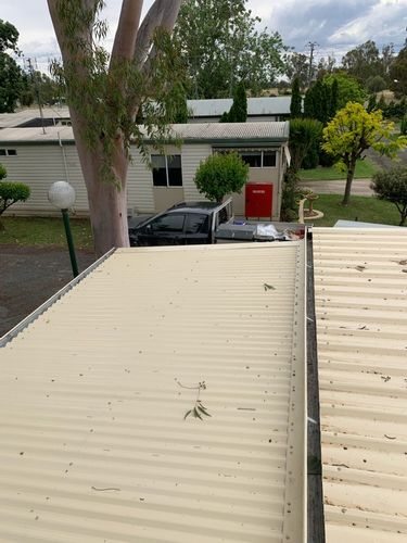

My She-Shed suffered a direct hit from a falling limb off the majestic rivergum which shades my home sweet home. The complete new roof is now finished and I'm in need of advice on the best product to prevent leaf litter, and plenty of it, from blocking guttering and downpipes. The plastic mesh is out as the crows and other birds pull it out and away. Not much of a fall on the roof either. Please advise.

You'd certainly want to avoid the really budget plastic gutter meshes as they are particularly flexible and easily removed by avian antagonists. The more robust plastic versions are better, but I've still seen cockatoos remove them with ease.
You've got a particularly small amount of gutter exposed there and it limits what type of protection can be used. For the lower corrugated roof, you could install GumLeaf 2mm Hole 1200mm Classic Cream Corrugated Roof Gutter Guard and we could enquire to see if a Klip-lok version is available for the upper roof. These can be semi or permanently installed and look fantastic, seamlessly blending into the existing roof. They are brilliant at excluding leaves, but cleaning out sediment buildup can be a bit of an issue since removing them can be difficult. The gutter would likely require a periodic blast out with a high-pressure sprayer.
Another alternative would be to use Whites 110mm Outdoor Fire Retardant Gutter Bristle. They do quite a reasonable job of keeping leaves and debris out and are easily removable to conduct a full clean once a year.
The last option that might give you complete screening of leaves and the ability to remove them every few years for cleaning would be Whites 300mm x 10m Fire Guard Gutter Mesh. You'll find it easiest to install if you remove the last row of fixing screws from the roof sheets. You can then slip the mesh up under the sheets and then bring it forward to sit within the front lip of the guttering. The roofing screws are then fixed back in. Every few years, you remove the screws and mesh to give the gutter a thorough cleaning.
Let me know what you think of those options and then we can discuss further.

Hi Mitchell, Thank you for the kind words, and you're right - so very stressful to deal with in the middle of Covid with material shortages and staff in             isolation, etc..So I'm very grateful for your splendid advice.
     After careful consideration I feel;
A. The Gumleaf 1200mm Classic Cream Corrogated Roof Gutter Guard sounds good, but being difficult to remove is a turn-off, especially as a                   pressure  wash may be required for cleanout of gutters.
B. Likewise for the Whites 300mm x 10 mtr Fire Guard Gutter Mesh. Removing the roof fixing screws to install it could be expensive even if it does the         best job and has the least ongoing maintenance. So......
     I think the Whites 110mm Outdoor Fire Retardant Gutter Bristle should be fit for purpose.
     The bristle option sounds easier to install in my small gutter access and that's important. Also, I currently have the gutters cleaned every 3 or 4             months so if the bristles extend those times I'll be happy. If you concur I'll be very happy. Thank you again for your welcome assistance Mitchell.

It sounds like the bristles might be your best option @Trying. They'll definitely extend the times between cleanings and are easily removable.
