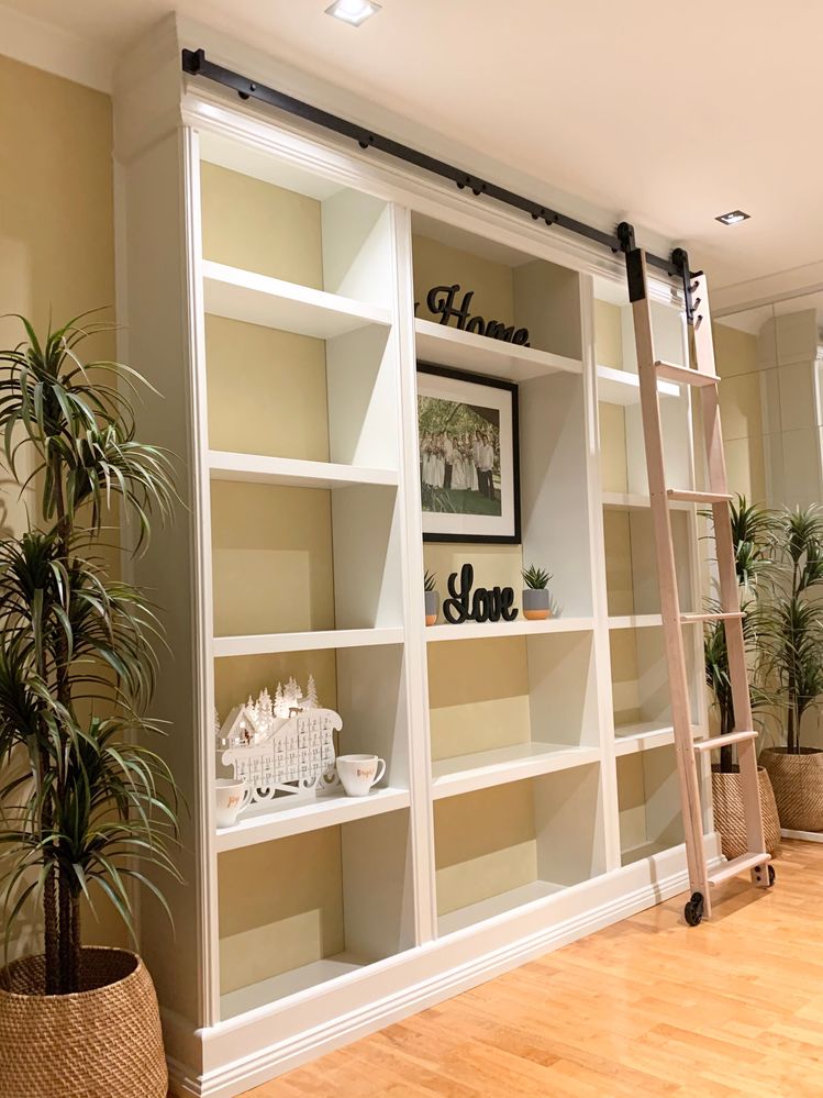

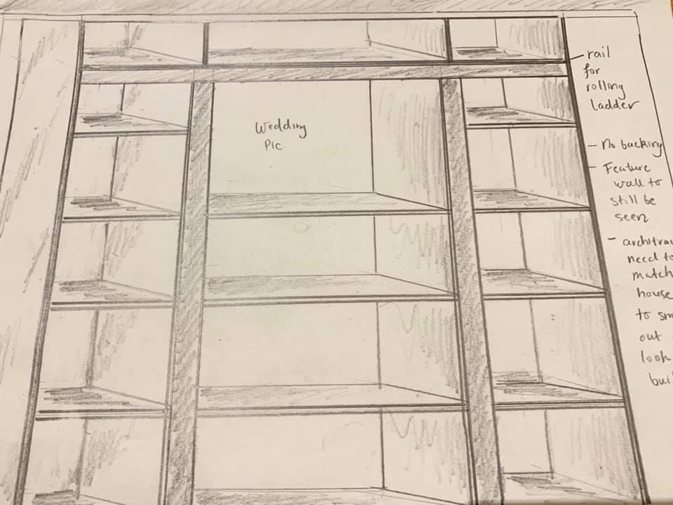

1. Drew a rough design of the inbuilt shelves and made sure to measure correctly to the wall where we wanted to build it.
Step 2
2. Bought all the materials required as listed above.
Step 3

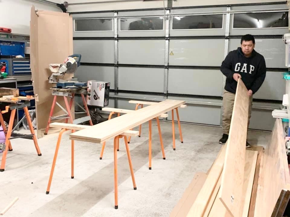

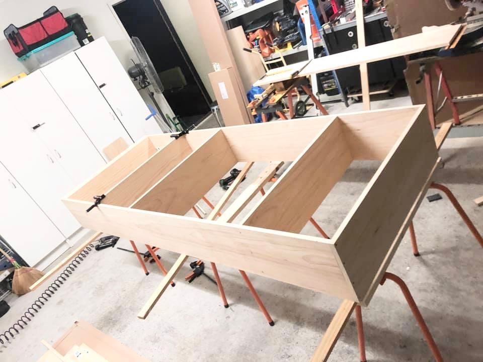

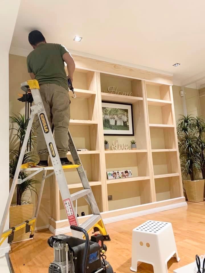

3. Built and made each shelving units separately.
Step 4

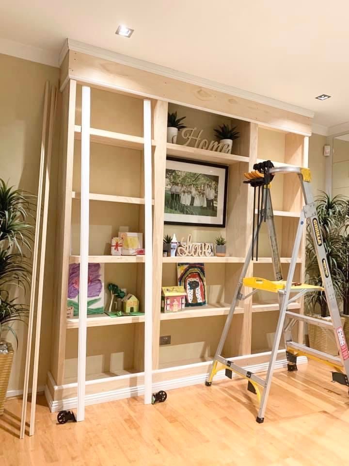

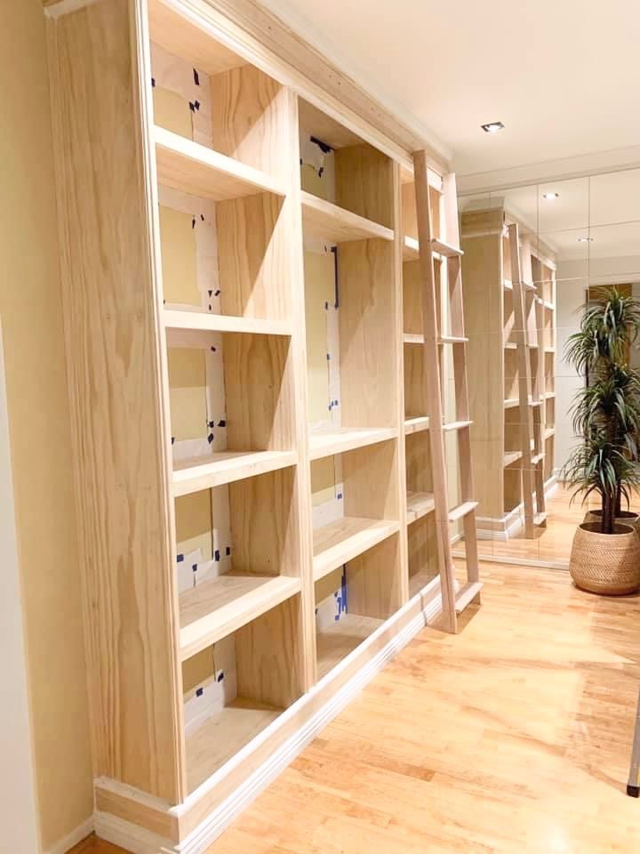

4. Mounted shelves together onto wall and added the mouldings and trims to close all the gaps and joineries from ceiling to floor.  Roughly built ladder to size.  Put paper inside the wall shelves in preparation for painting.
Step 5
5. Filled in gaps, covered nails and screws, and sanded polished the entire shelves.  Wiped and cleaned shelves with wet microfiber cloth in preparation for painting.
Step 6

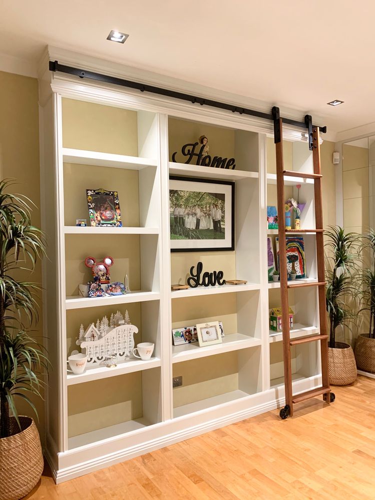

6. Painted the shelves.
Step 7
7. Roller track assembled.
Step 8
8. Ladder stained.
Step 9

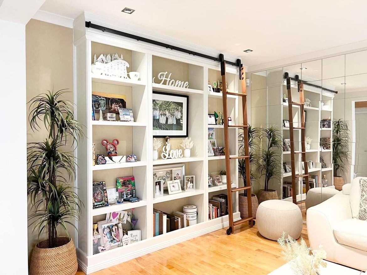

9. Decor added.
Step 10
10. Before and After.
