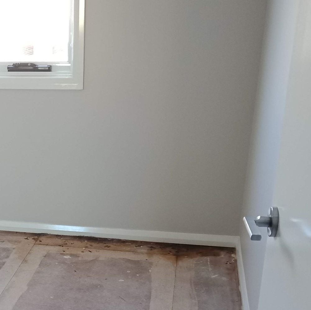

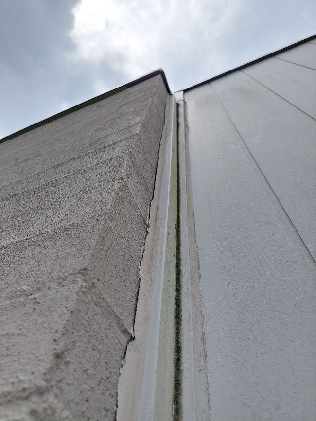

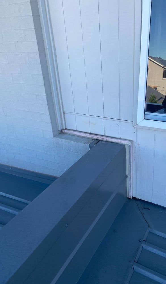

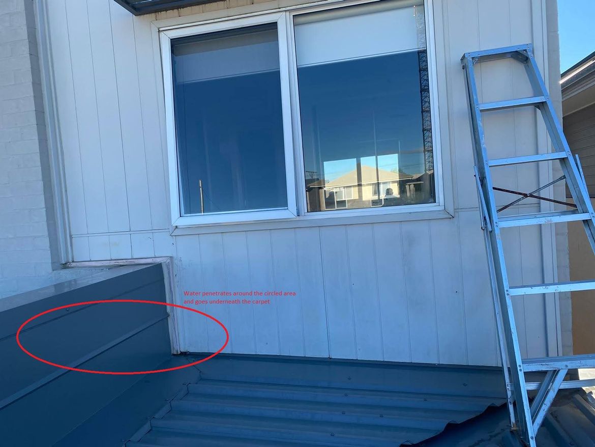

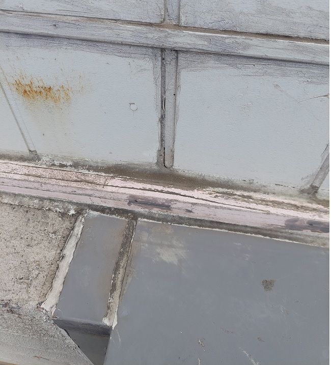

I moved into a house a couple of years ago and been having few issues with leakages, unfortunately. Now I am trying to fix this problem where water gets inside one of my rooms, underneath the carpet. At first I thought gaps around the window would be the issue, but if you look at the last photo, the water is more towards the corner of the room, rather than below the window. I think it comes in between the cladding and the brick wall, and possibly also between the metal and the wall (see photos). The caulk doesn't seem to perfectly adhere to the wall anymore.

It would be good to cut the failed no more gaps out with a sharp stanely or razor knife as some no more gaps is indoor mostly it the no more gaps still whole no need to cut out if you think it still sound. Do you think no more gaps fix the problem for a while? If true then that is were leak might be.
So if you spot any cracks any where eg the mortor in the bricks has cracks as per you photo seal them all as necessary Seal everything
2 Seal around all window timbers or better take that window trim off and seal the actual window to the frame then re add your trim.
3 Seal along that horizontal to the wall with the cracked no more gaps.

Pic #1 - That flashing needs to be removed and see what is under it, if it is leaking it seems like either there was no sealant or barrier put under it before the whole thing was fitted
Or the sealing was so poor that it failed in a shorter time than it should have.
While you are in that area, I would check the "fall" (with a level and a ruler) on the roofing profiles below that flashing, from what I can see, it almost has a "negative fall" back into the area under the flashing.
I could be wrong, that's just how it looks to me, which could account for some of the water ingress below it.
Also suspect that junction between the wall and the flashing, water can get in by mere capillary action, as in it will flow upwards, it won't be a lot of water, just enough to cause damage.
Pic #2 - The wall has moved over time, meaning that the then installed flexible sealant has probably lost contact with the wall.
Easiest way to fix this is to strip all of that adhesive out and use a reputable primer on the surfaces before filling it with new flexible sealant/adhesive.

@MikeTNZ - in Pic1, if I understand what you mean, then the fall goes this direction \ (that is, downwards from the junction to the right of the picture) - hope it makes sense
.So technically any water should flow that way to the outside of the building.
