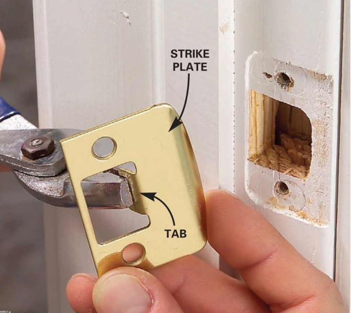

Re: your sticking problem, each time a door is painted, your adding almost another mm of thickness to it, which effect how well the door will make contact with the door stops (thin internal door frame) and door latch sticker plate. You might be able to adjust how the door is currently latching by bending inwards the latch plate tab as per the photo.
If you want to restore the door back to a gloss finish, then it will most likely need to be sanding back first to allow for the thickness of of new coats of gloss. You won't need to sand all of the door, just the outer 50mm on the inside panel.

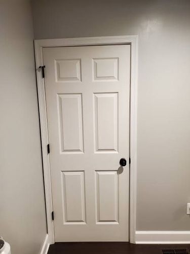

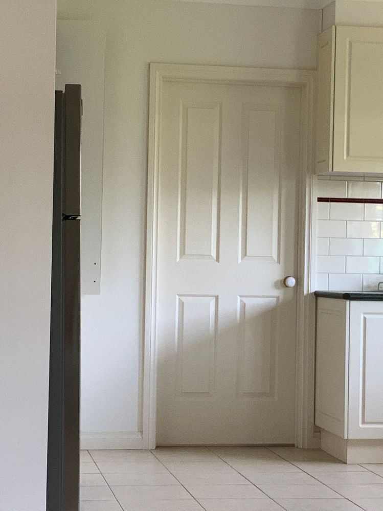

Could you take a photo of the door when it’s closed to show the gap around the door.
If the door is correctly installed you should have an even 2-3mm line around the outside of the door, If there is a larger gap on one side it could give us a bit more information on where the problem lies.
It’s likely the solution will be one of two things, adjust the hinges, or remove some material from the door, whether through sanding or planing the door.
If you take some photos of the gaps around the door like below, I should be able to help out.
