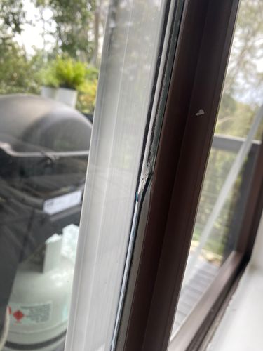

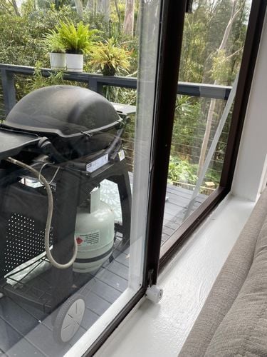

Hi, our living room window has lost some of the grey sealant which is between the glass and frame on both sides. I was wondering what product would be best to replace it? It seems to be a solid material rather than a filler. I plan to paint the exterior replacement.
Please see photos.

Hi @Sshep88,
This product is often referred to as glazing wedge and there are a number of different sizes that are specific to the thickness of the glass and the cavity that the glass is installed in.
Unfortunately, the only recommendation I have is to contact a glazier for their assistance. They will have the product knowledge and skills to replace this on your behalf.
I'd suggest using a service such as HiPages or True Local to find a glazier who operates in your area.
