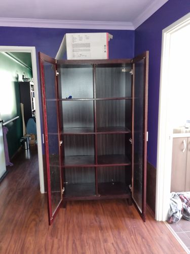

Hi, I'm doing a restoration of a cupboard we got free online.

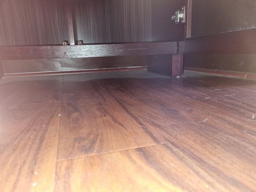

It's a bit wobbly so i figuered i'd use a sander to sand down the wooden legs to even level. Please suggest a better way if you know it?

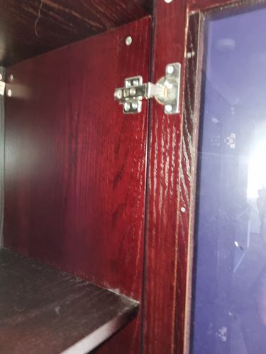

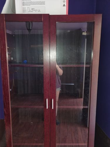

What i'm more stuck on is the doors. They're very uneven, more so then the wobble should allow for so need some advice on straightening them out?

Thanks for sharing your question about restoring your cupboard. Before you begin sanding the cabinet down, I suggest fixing the cabinet structure first then followed by the door alignment.
I recommend using a Craftright 250mm Try And Mitre Square to determine if the cabinet body is square. I suggest adding a few more screws to the ends of the cabinet to stiffen the structure. When the cabinet is square, the doors in theory should be very close to being lined up. The door hinges do have adjustment points on them, but I suggest starting with the cabinet structure before you adjust the doors.

Sometimes the screws holding the cabinet square become loose and even if you tighten them up the cabinet still tends to lean in one direction or another. In order to fix this, I suggest adding a few screws where the end of the panels meet together to re-enforce the corners of the cabinet. I also suggest having a look at using Zenith 50mm Stainless Steel Angle Bracket inside the cabinet to brace the side panels and prevent the cabinet from leaning.
I've placed a sample sketch below to give you an idea of how to re-enforce the cabinet base.
