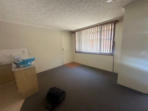

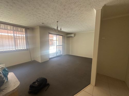

Just bought a 1 bedroom unit which has concrete and some plaster walls. Plaster is for the plumbing voids.
Am wanting to DIY repaint it, but am just wondering the steps/ products required for a repaint of concrete walls and can the same paint be used for both wall types?
