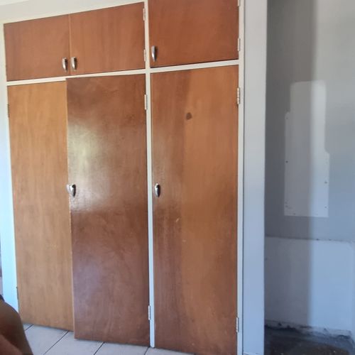

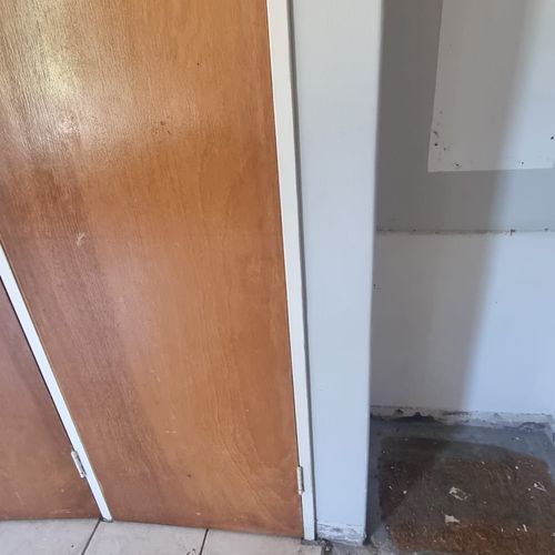

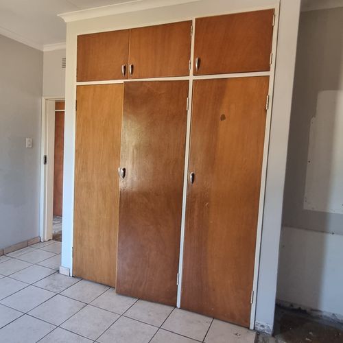

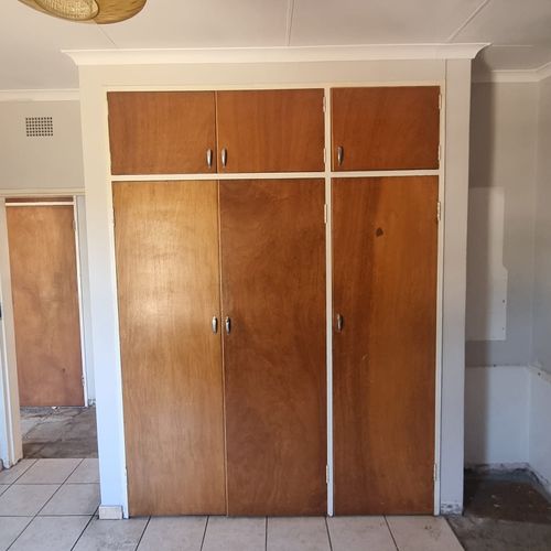

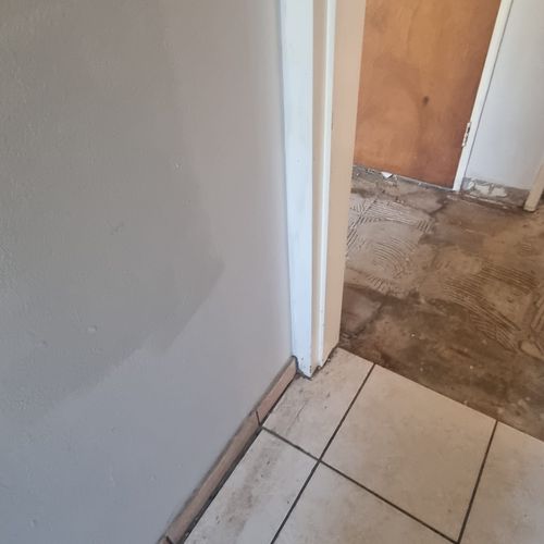

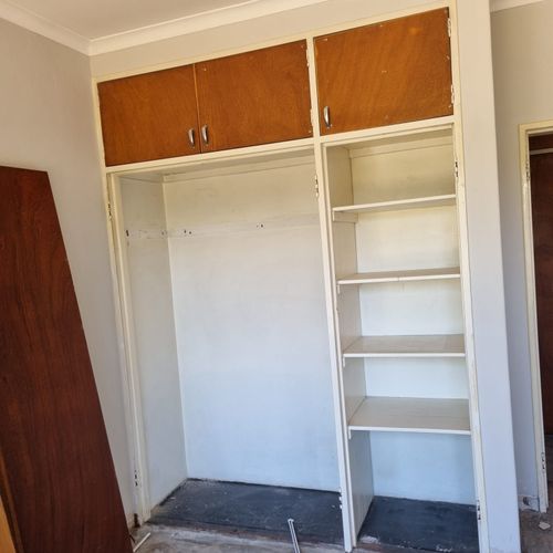

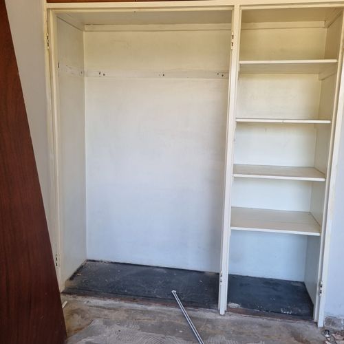

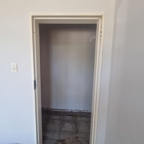

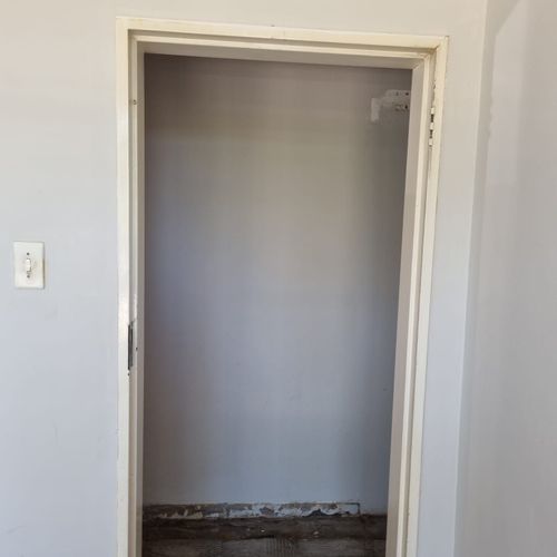

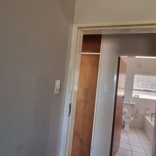

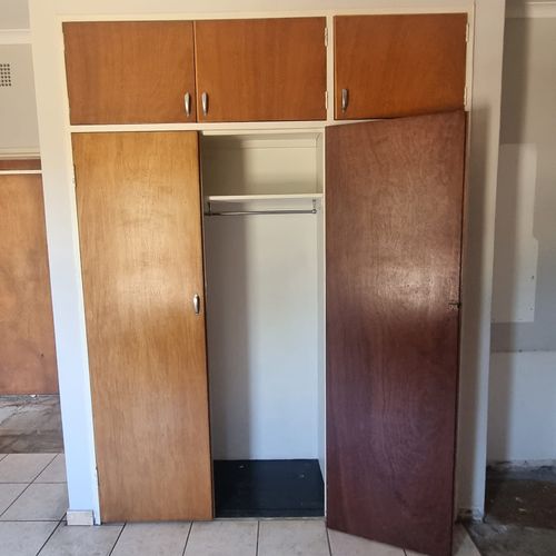

Hi everyone,
I have steel built-in wardrobe frames as well as steel internal door frames set in brick walls. I'd like to remove them entirely and replace them with wood frames. It's an aesthetic thing, I guess. But I also don't want to cause damage to the walls or hurt myself in the process and would like to know how to remove them safely step by step. My husband will be assisting but we are not certain what the correct process is. Any guidance will be helpful. (see pictures below)

It sounds like you're tackling quite a project, and it's great that you're thinking carefully about the process. The steel frames in your built-in wardrobe and door frames are doing more than just holding the structure of the door—they’re also supporting the bricks above. Without these steel frames, the bricks would be left unsupported, which could cause them to shift or collapse.
If you want to remove the frames, the first thing you’ll need to do is support the bricks above. This is typically done using a steel lintel, which is a horizontal support placed across the top of the opening to hold the brickwork in place. Before you start removing anything, you’ll need to install props or some type of temporary support to hold up the bricks while you work.
Cutting the frames out can be tricky, as the brickwork often sits within the top of the steel frame. To do this safely, you may need to carefully cut the frames out using an angle grinder or reciprocating saw. However, you'll want to take it slow and be prepared with the right props and supports in place before removing the frame entirely.
Given the structural importance of the steel frames, I'd strongly suggest enlisting the help of a professional. They can assess whether the frames can be removed safely and advise you on the best way to install the necessary supports or lintels. This will help ensure you don’t damage the brickwork or put yourself at risk during the process.
