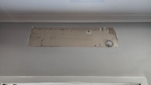

We recently upgraded to a ducted AC system, and had four aged split systems removed.
They've left the usual holes which will need patching, which the installers plugged with insulation for now.
One of them also seems to have been installed before the intenal render was applied, leaving an empty space to be filled (see attached pic).
How should we fill the piping holes and how should I fill in the missing render?
Thanks in advance!

In order to patch small holes, I suggest using UNi-PRO 500g Multi Purpose Interior Filler - 500g. To repair the larger hole, I propose using Hyde 127 x 381mm Wet And Set Plaster Repair Patch. You can use the multipurpose filler for the wet patch as well. Please remember to fill only to the level of the wall so that you won't have to sand a great deal off.
Once all the fillers have cured, I suggest using a Trojan 220 Grit Jumbo Sanding Sponge to flatten the area. Wipe down the area very well before you prime and paint the wall.
