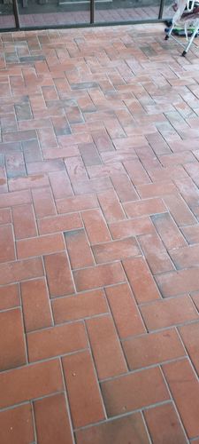

I am looking for ideas to improve the looks of my sunroom which is enclosed and covered.. the tiles are terracota( I think) as per the photo attached. This room is the only way I can exit my hall and enter my garage or enter the yard. I am currently using a corner of this as a home office.
The challenge is that the floor tiles have this scaling or salt deposits ( as per a friend). I dont want to spend too much on reflooring and hence looking for a diy option which doesn't require a lot of effort( weekend projects) or power tools.

Thanks for sharing your question about improving your terracotta floor tiles. Your tiles appear to have efflorescence on it, I recommend using Crommelin 4L Efflorescence Remover to remove the salt deposits on the surface. Giving the tile surface a wash and polish is one of the ways you can improve your floor tile.
However, if you are after a total change, the next best option is using Hybrid Waterproof Flooring. This is one of the hardiest flooring options you can install in your sunroom that can withstand heavy moisture and warm temperatures. It's relatively easy to install and does not require power tools. It will totally change the look of your flooring.
