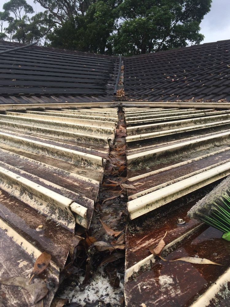

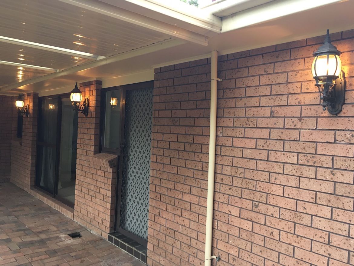

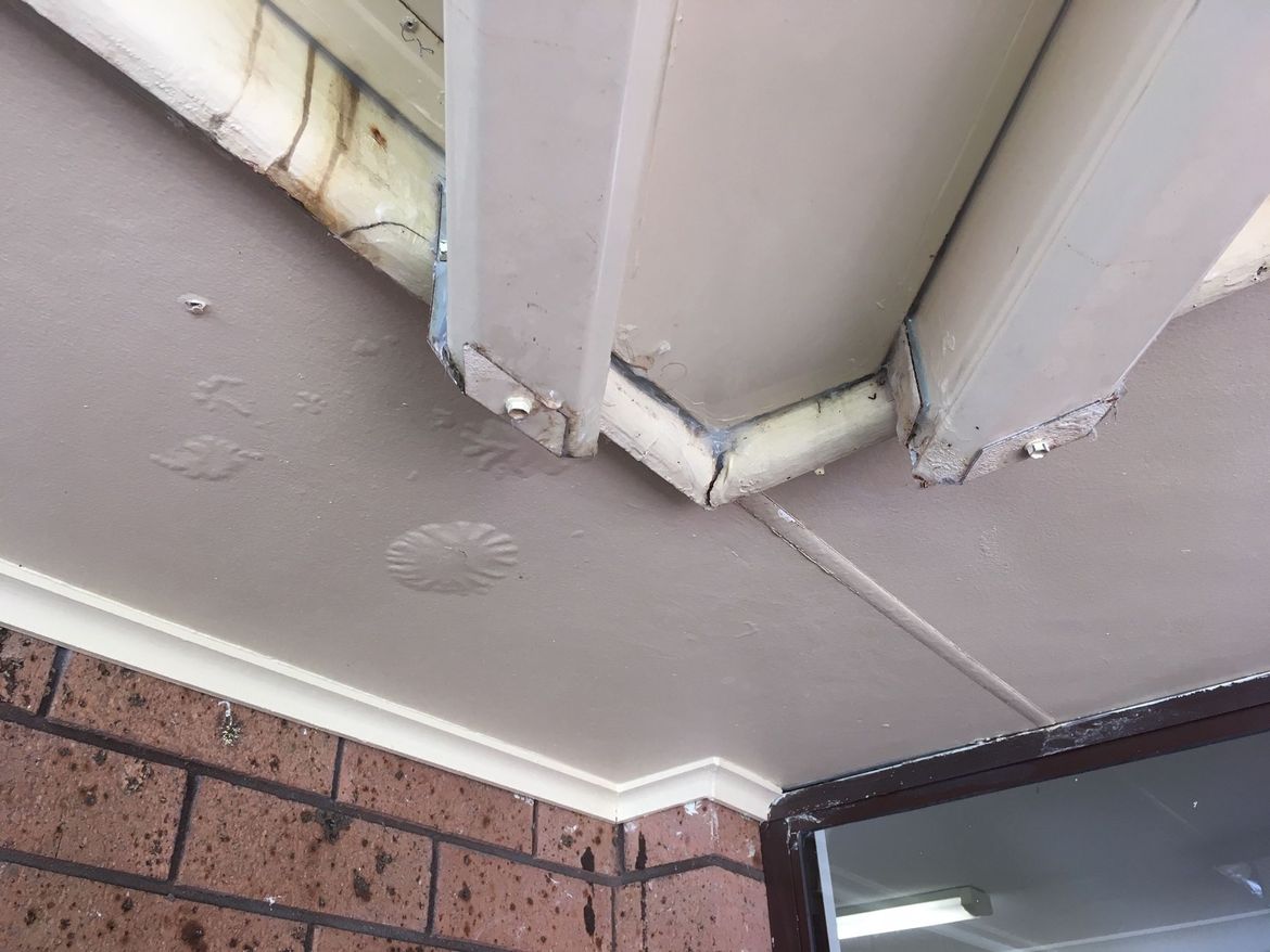

Hi Mitchell,
Attached some photos, the stains on the fascia board show where the leaks are happening. The following Stratco document in the "outback flat" section has clearer diagram how the back channel is attached to the fascia, note the bitumen impregnated foam insert, this is the part that's old.
Can't replace the bitumen foam seal without taking the verandah apart and not all areas leak.
Re: Suggestions fixing verandah leaks
Hi @Paul226,
Appreciate those images and additional information. Ultimately the sheets should be removed and the foam seal replaced. The next best option I can think of is trying to prevent water from accessing the rear of the sheet. I'd presume you'd be able to fit a Crommelin Superseal between the gutter and the sheeting. Hopefully, that would prevent water ingress to that back seal. You'll need to clean the roof sheeting thoroughly and compress the Superseal into the gap. It wouldn't hurt to use a Brushable Waterproofer between the sheeting and the seal, so water doesn't get under it.
If you see one of our helpful team members at your local store's Special Orders desk, they'll be able to order the Superseal in the Klip Lok profile to suit your roof sheeting.
