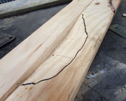

Just so we're on the same page @Samnet, this is how I intended the repair to go.
You have a big chipboard chip - something like this and with an opposing intact vertical edge...

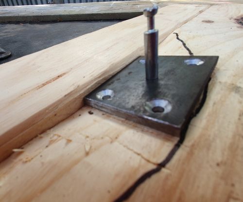

With the pin/bracket positioned in the panel and with the dowel spacers intact - lower the panel into place. That way you can mark out the site and determine if wood needs to be chiseled away.
Re: How to fix particleboard table leg?
Ideally the top of the plate will eventually be level with the wood.
A straight edge will help.
You can see the chiselled out area is now level but there is  a larger gap at left.

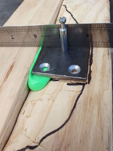

This is where Builder's Bog or something similar will come in handy.
(My fluorescent Builder's Bog here is orthopaedic putty.)
Return the panel with the attached bracket and press into the Bog - till the top plate is level - and let it set.
