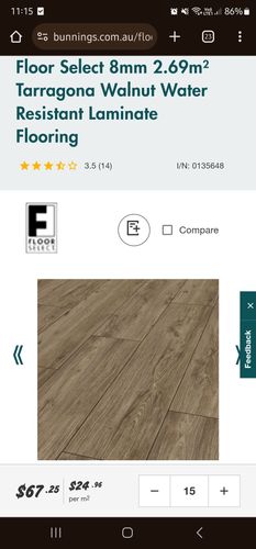

We are going to be installing Floor select Tarragonna walnut laminate flooring (as pictured). First time ever installing flooring ourselves and are looking for some pointers as to what we use for the transitions. We have multiple transitions leading into different rooms with other rooms being tiles and one carpet. What product is best to use for the transitions in these spots. I have looked and cant seem to find an exact orresponding product to the flooring we have purchased. Also what would we use where the flooring meets the back sliding door?
