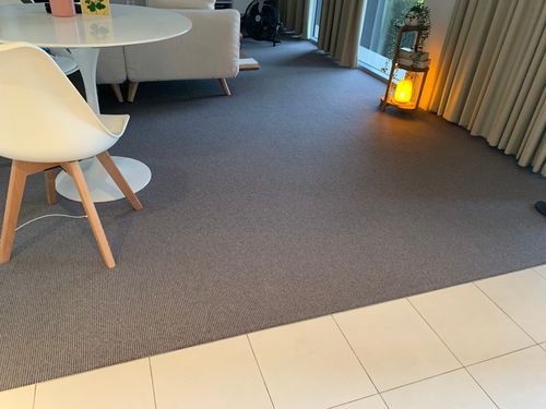

Hi, I want to replace the carpet laid on concrete in my 1BR apartment with either vinyl plank or hybrid flooring. The building has a minimum acoustic hard level of 50db.

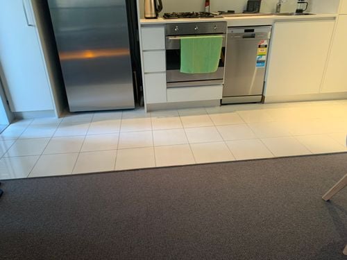

2. There is a row of tiles in the kitchen area at the rear of the living room. Should I remove the tiles and lay the hard flooring throughout the apartment , or leave the tiles and lay the hard flooring alongside? The tiles are in reasonable condition, though need regrouting and buffing, or maybe colouring?

My main concern would be avoiding changes in the height of the flooring, so if the tiles are the same thickness as your flooring, I would leave them in place and butt up to them, using Transition Cover Trims to cover the gap. If the tiles are not the same thickness, I would remove them and lay your new flooring across the whole area.

When you advise to check the flooring height of the tiles and hybrid , do you mean a measuring the tiling height and hybrid before ordering,? I don’t think the vinyl planks would be as thick as the carpet and would be lower than the tiles . Would the transition cover trim correct any height difference ? The acoustic vinyl sample plank I have is 5mm.

I would think that @JacobZ does mean to measure the height of the tiles to the concrete before ordering. It will help show if you need to add a layer of material or decide to remove the tiles. Having as small a transition within a floor area would be the best option.

Thanks for your advice Dave. I saw Bunnings had some paint for tiles . I thought painting mine might be an option as they are cream in colour and I was looking to install a grey toned hardfloor covering , which wouldn't blend well with the tiles.( if I keep them )

Yeah I know that feeling, I was about to say that you are heading towards ripping up the tiles. Then I looked at your area nad realsied you have your stove and hotplates, sink and fridge. All stuff that commonly has either water or grease spatters. Maybe paint a corner somewhere out of teh way and see how it looks and after a week or so see if it scuffs easily? The boards wont take to water particulary well over time. 😕
