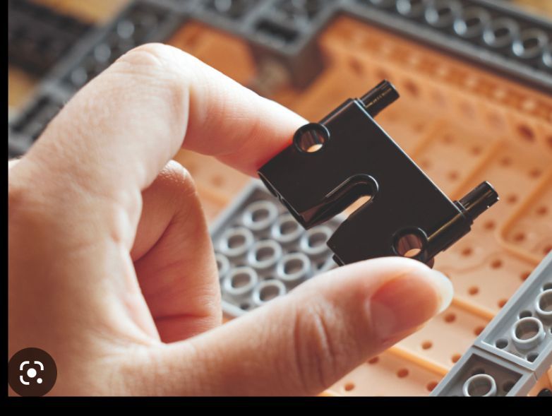

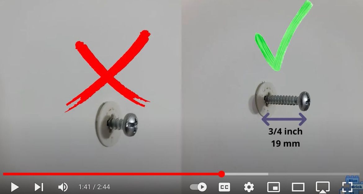

- I’m looking to hang a Lego wall art, and the design of the back mounts require a screw that sticks out around 20mm (image attached for reference). Is this a case of buying a longer than needed screw, and screwing it into a regular wall plug.
