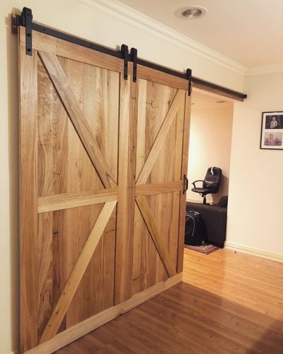

This would have to be one of my favourite builds. I have always wanted to Build a barn door and now I have made one, I can’t wait to be building more.

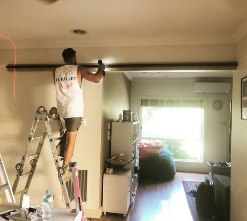

Hanging the tracks is not a complex as it looks once you learn the heights and measurements. The timber I used is called Silver Top

i thought about wanting to use Tasmanian Oak but I was after 14mm tongue and groove.
In this case the door needed to one piece as so I made two doors, then when I hung them I joined the doors from the back making it all slide as 1.
2.3m high and 2.0m wide:
To make the door I used 130mm x 14mm tongue and groove. I run a bead of glue along each groove and joined the whole door together with clamps leaving to dry over night.
Next step was to cut the door square to the correct height which I used an ozuto plunge saw, but a simple circular saw along a straight edge works fine. ( another way is cutting the correct lengths from the start before glue up, but things never goes to plan and may never line up square.)
For the top layer frame I also used the 14mm silver top tongue and grove, but I cut down both sides of timber removing the grooves and leaving a nice square edge making it 115mm wide. I glued and fixed all the planks with a brad nailer. Which I also nailed from the back as well. I didn’t want to use screws as I didn’t want to see so many holes which I then would have to putty

Many thanks for the construction image and the details of how you put it all together. It was ingenious thinking to use the tongue and groove as I trust it made the glue up all the easier.
