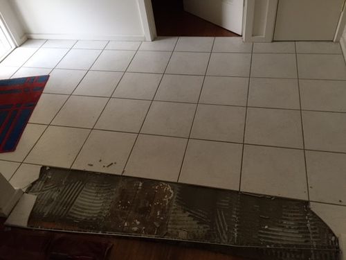

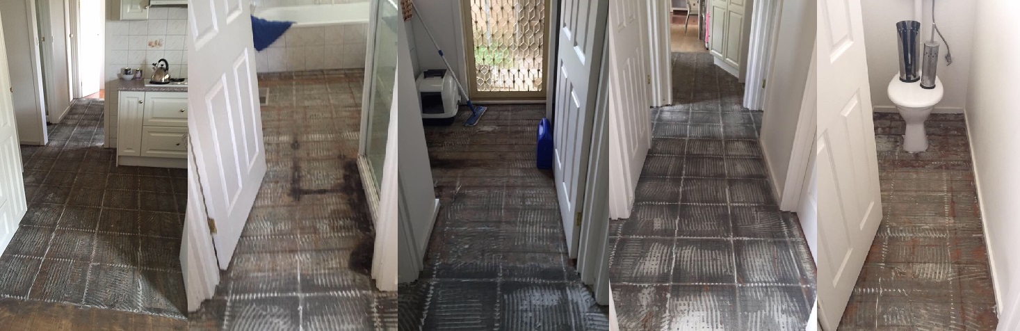

So essentially there was 33sqm of this stuff in all the wet areas and the entrance - yuck!
undefined
Job 1 - Remove all the tiles (1 day)

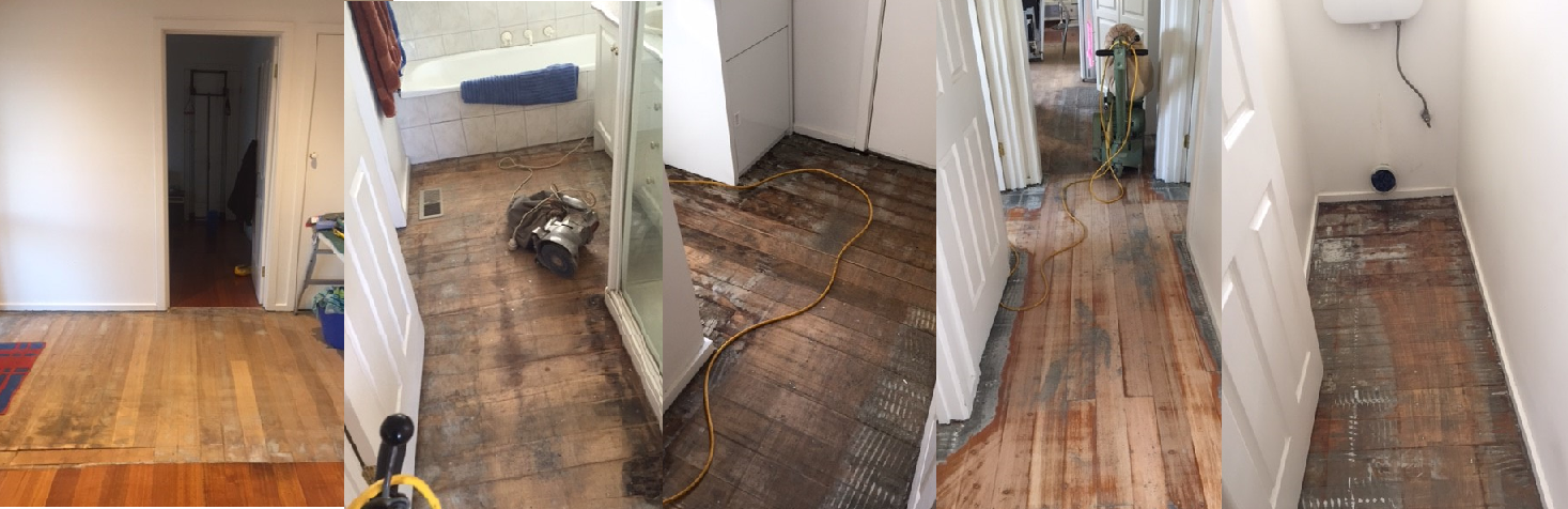

Job 2 - Find the floorboards underneath the glue (1 day with sander hire)

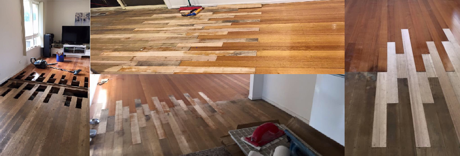

Job 3 - Pull up floorboards in hallway and stagger into new floorboard area (2 days and broke my wrist!)

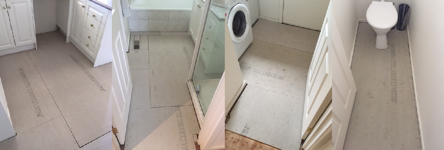

Job 4 - Lay cement sheets (1 Day - Wish previous owners had done that!)

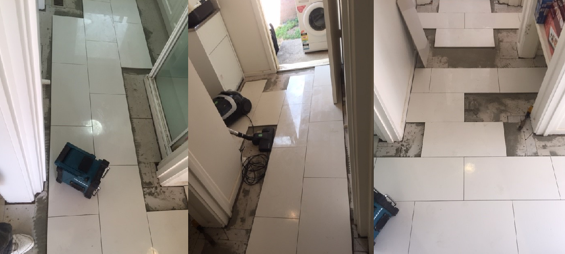

Job 5 - Lay tiles (3 Days including cutting)

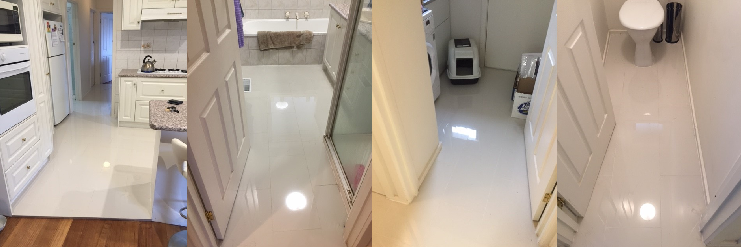

Job 6 - Grout, seal and wipe down (1 Day)
undefined
And there we have it!  We have taken 33sqm of bland square tiling (320 x 320mm) in the wet areas down to 20sqm of gorgeous larger (600 x 300mm) porcelain tiles and added 13sqm of wooden floorboard area to the open planned lounge and dining area (previously the dining area was on the old tiles).
