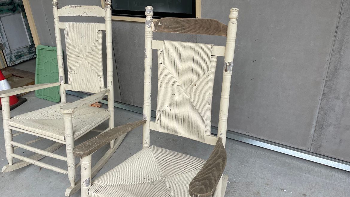

Originally I had planned to give them sand and paint them all one colour, but as I sanded, I realised just how beautiful the wood was. I mean, these are old chairs, and the wood has aged beautifully, so to cover them with paint felt like I was doing them a disservice. So instead, I started scraping and stripping them.

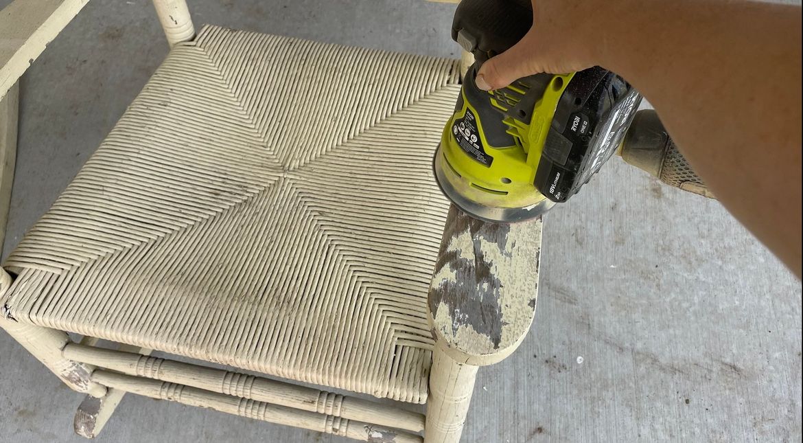

Step One: Sand
I started with the sander for the flat areas like the hand rests and base

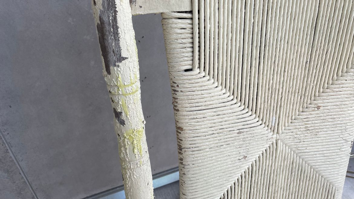

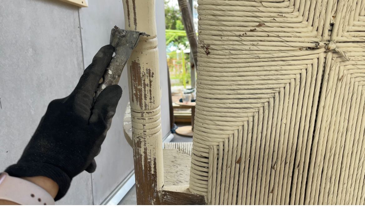

Step Two: Remove Paint from decorative posts.
If I continued with my plan to paint I would have roughly sanded them using a hand sander however as I loved the wood so much I decided to take off the  paint. I thought using a paint stripper was the only option. I started by painting the stripper over the old paint. The results were ok and it was effective in lifting some of the paint, once it bubbled I removed it with a scraper. But in my experience paint stripper takes multiple applications to be effective.
Then I was handed a scraper with a blade and that was it. Not only was this tool effective and fast at removing the paint but it also left some of the undercoat and paint leaving a beautiful aged/ weathered look which I didn’t realise was exactly what I was looking for.

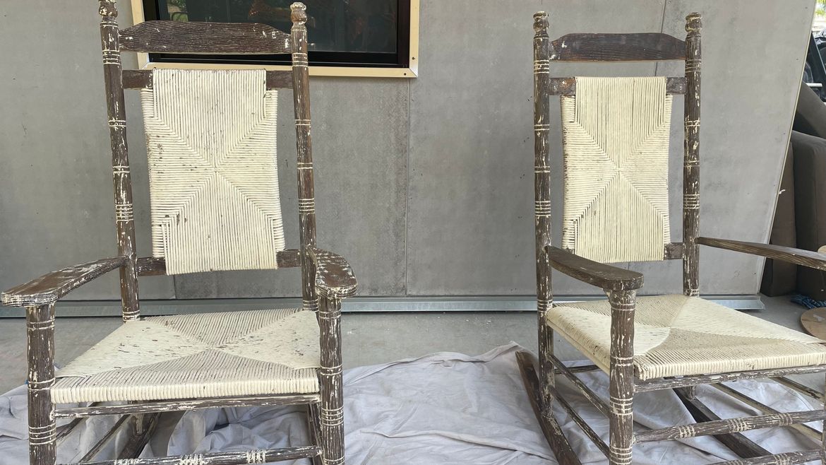

The second chair I used the sander on the arm rests only and used the scraper with the blade on the rest of the chair and it took me half as long!
I was still unsure what to do with the weave – I couldn’t remove that paint so had planned to freshen it up but once I saw how the wood looked the worn paint on the weave looked perfect!!

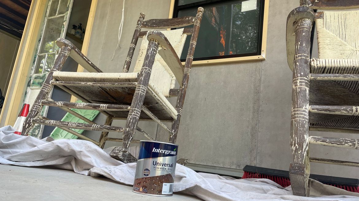

Step Four: Oil them for protection

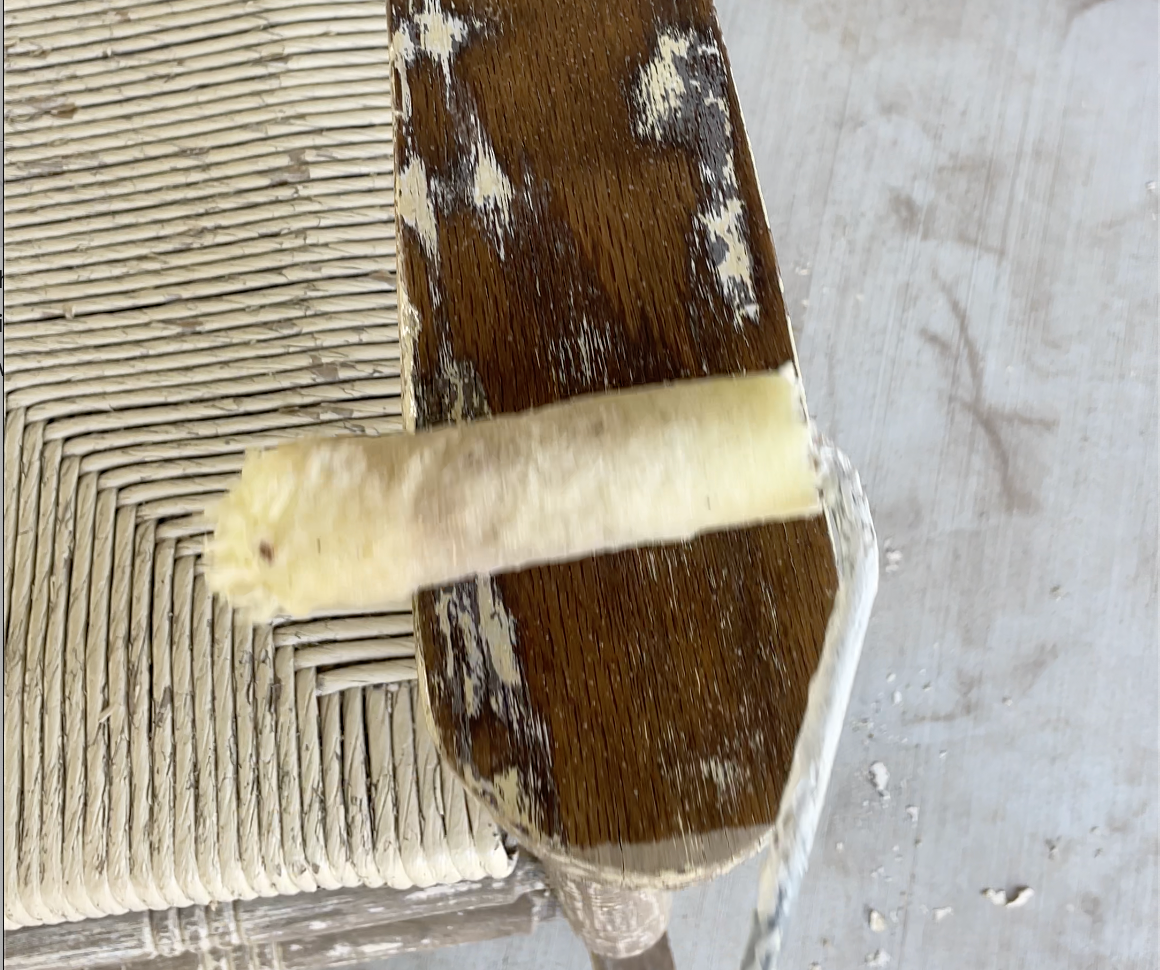

As these rocking chairs were going to be left outside I used a decking oil to finish them and protect them. I applied the coat using a roller, let it dry for 24 hours and then applied a second coat.

So in the end I didn’t try to make them look shiny, I made them look perfectly weathered, perfectly aged. I love old furniture and I love the beauty in imperfection and so, for me, these chairs are imperfectly perfect.
