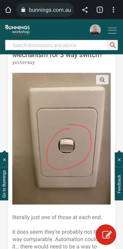

literally just one of those at each end.
it does seem they’re probably not three way comparable. Automation could do it… there would need to be a way to power just one switch without it actually operating a circuit (it you can press the button to trigger a scene but the actual switch does nothing). Could then just rewire one end of the hall to operate as a regular switch and then use the other to trigger scene “switch a on/off”
