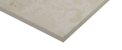

My question is...What's the best type of power tool to use for cutting a large diameter hole in fibre cement board?
