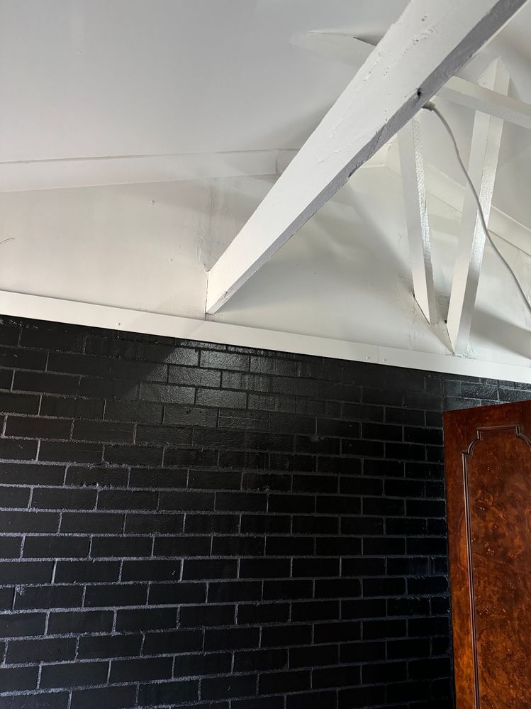

Hi everyone. I am in the process of renovating what used to be my garage, however, it is now fully enclosed, insulated etc and a functional home Spray tan salon as my second job.
I have been looking at skirting board options ( I need about 25 lineal metres) and have been considering MDF.  Normally, I would run a mile from MDF as I love real wood (I'm always fixing up old antiques), but when I did the skirting boards for the entire of my jarrah deck with Tasmanian oak, termites/white ants had an absolute bonanza. I've since treated. But they are definitely insidious fiends.
The floor of the tan room is painted with Rustoleum gloss. PTan Room.jpgerfect to be able to keep things clean and hygienic, and it is not a damp area. I have treated all the peripheral areas by drilling 10mm x 300 mm holes & just gone a bit wild with David Gray's, but I really don't want any termites thinking they can set up house. Hence the MDF. I did look at treated pine, but the reality is, that this house will not be here forever & I am at the stage where I need to justify how much capital I am investing. I'm of the understanding that white ants don't generally have a feast with MDF, but I thought the same thing with Tasmanian oak too.
I'd love anyone's thoughts.  Thanks very much
