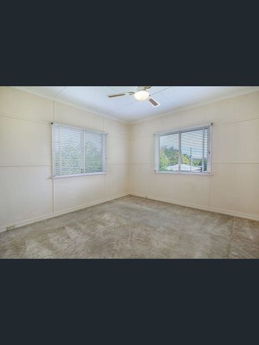

Hi @Summer2025
I do believe that is possible with out too much trouble.
Step
1/ Take off the timber strips
2/ Use plaster webbing tape off a roll and it sticks on. I might use two widths and over lap them if the sheets in the wall have a large gap 30 mm or so.
https://www.bunnings.com.au/gyprock-easy-tape-90m-plasterboard-jointing-tape_p0731009
3 / Then apply gyprock joint compound with a medium large metal spatula to fill the gap and over the top of the webbing until it is smooth and flat.
4 / Sand the walls smooth
5/ Re apply Gyprock topping compound into the little remaining blemishes and re sand ready for painting
Gyprock CSR 2.25kg Less Mess Topping Compound 0173348 $23.49
https://www.bunnings.com.au/gyprock-csr-2-25kg-less-mess-topping-compound_p0173348
Hello @Summer2025
Welcome to the Bunnings Workshop community. It's sensational to have you join us and thanks for sharing your question about removing the strips on your wall.
It's great that you've received excellent advice from @Jewelleryrescue. I was thinking of exactly the same thing, but Jewelleryrescue got ahead of me. My best advice is to check one of the strips first to confirm what type of wall covering you have.
Fabulous! Thank you! I have my next project sorted ![]()
Hi @Summer2025,
I'd also like to welcome you to the Bunnings Workshop community and say how fantastic it is to have you join us.
Please be aware that this method of joining wall sheets was common when asbestos was still used in homes.
There's a risk of asbestos exposure from homes built or renovated before 1990. Before starting any work, determine if asbestos is present by having your home assessed and taking necessary precautions to protect yourself and others. Access resources from the Asbestos Safety and Eradication Agency for guidance on safe practices. Prioritise safety by educating yourself and seeking professional assistance when needed.
I'd highly recommend having your home assessed and tested for asbestos by a suitably qualified person before proceeding with this project.
