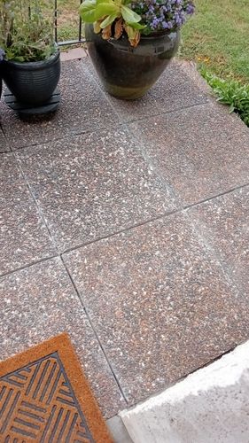

I want to repoint my outdoor pavers..they are exposed aggregate( I think this is what they are called) so not smooth. I'm currently grinding out the old mortar..but I  don't know what to use on these pavers because they arent smooth and i don't think I can slosh anything over the whole lot like I've seen videos of with smooth pavers.
Anyone have any thoughts?

I'd suggest using SikaCeram CleanGrout. Mix it up in a Flexi Tub, and apply it to the gaps with a Ezitile Jap Style Grout Float.
Push it into the gaps and then clean up any overflow with a damp sponge.
This will give you a nice clean finish with minimal cleanup required.
Alternatively, you can brush Cemix 20kg Pavetight Sand into the cracks, vibrate the pavers with a plate compactor to make it settle tightly in the cracks, then lightly wet it down to lock everything in place.
