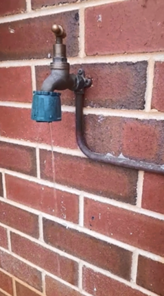

One of my outdoor taps has started leaking - how do I fix it?     Replace a washer or replace the tap?

Yes, you can replace the washer within the tap to resolve the leak. You'll need to first turn your water off at the mains and then unscrew the spindle, which I've highlighted below. To undo the spindle, you should use an adjustable spanner. Once you've removed the spindle, you can replace the washer and then reassemble the tap.
